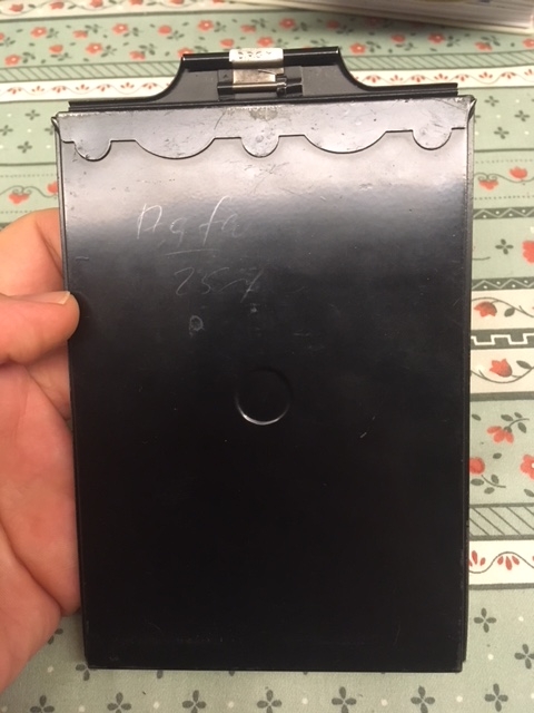

Thanks, it is what I need to know. I'll check mine this evening at home and see what kind of holders will fit. it's better to find a range of manufacturers and look for those. I seem to remember that agfa, zeiss ikon, voigtlander, ica and KW were all the same design, but have to check as very small differences in rails and dimensions could be difficoult to be evaluated buying online. are those in your picture fitting properly your avus?

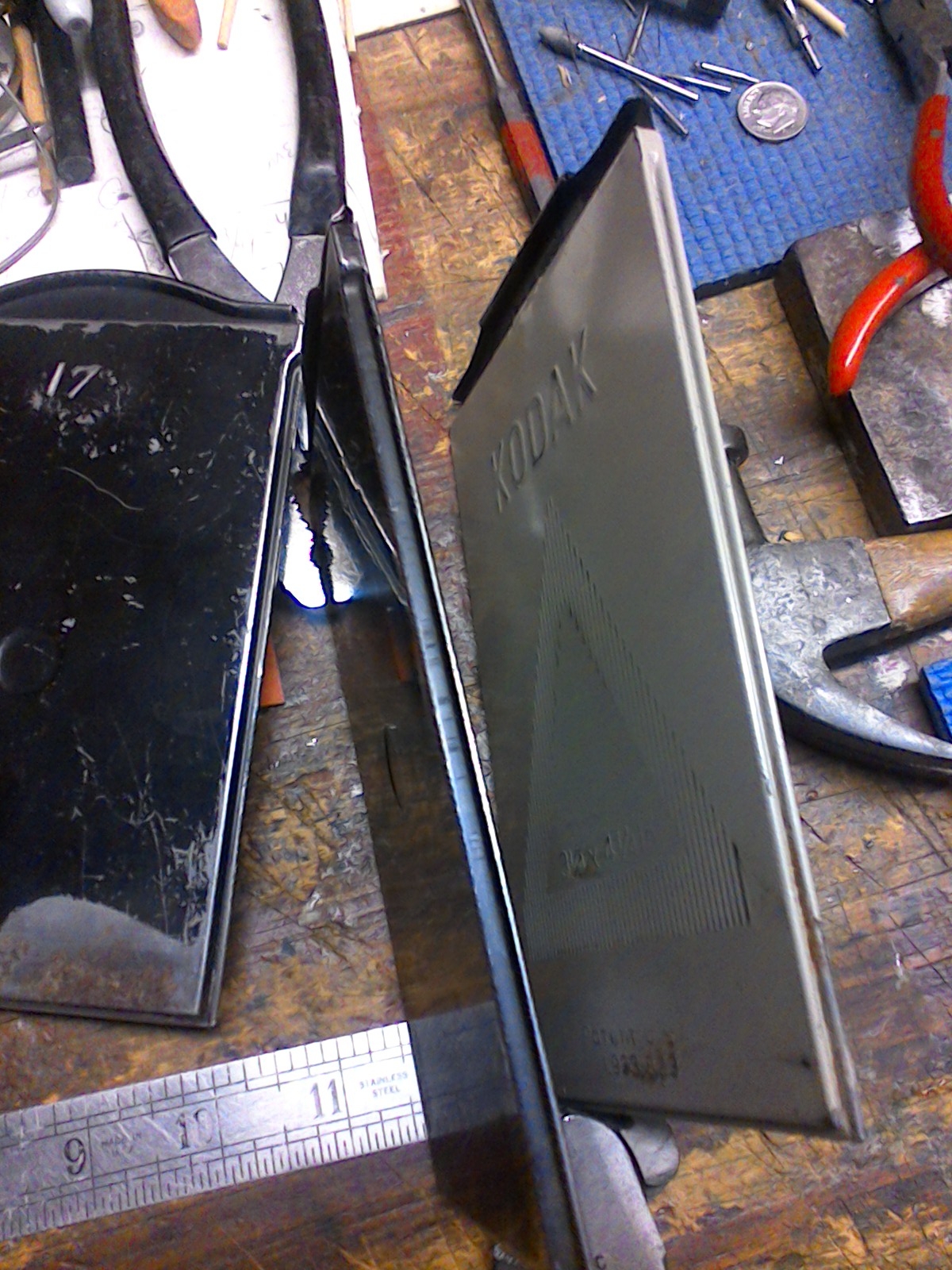

these are working perfectly. the kodak i noticed has a different lip but fits perfectly as well. the lip thickness is the same as the others.
I measured the outside dimensions of the black holders.... 100mm x 150mm
The lip is 1mm thick x 1.5 mm wide.

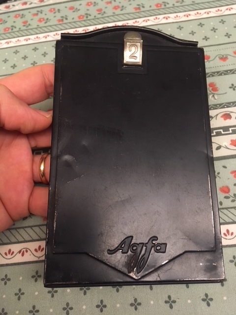

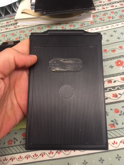

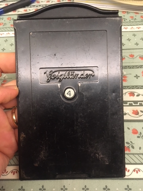

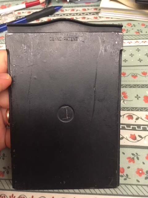

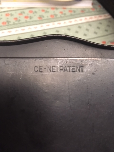

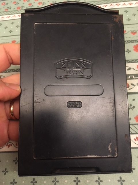

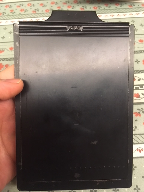

Well, checked some: the voigtlander, the zeiss 665/7, the agfa, the plaubel, and some others umbranded will fit fine; i can show some pictures of some from my collection that will help you to look for the right ones
