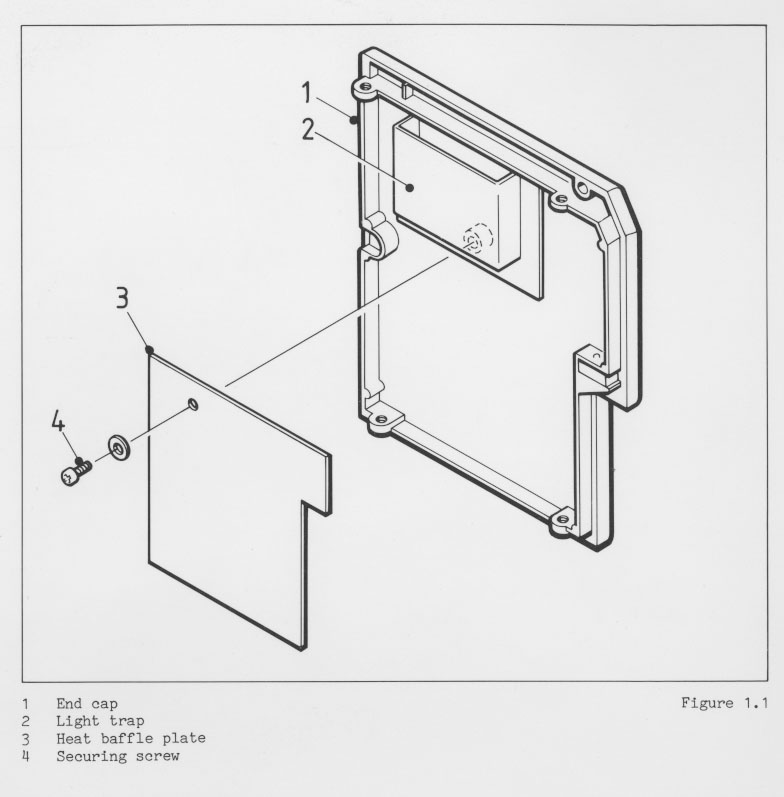

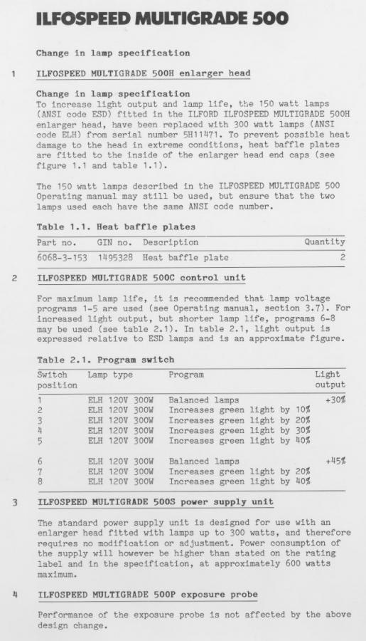

I had a slightly closer look at the manual of the 500H head that I have, and noticed there was an extra "supplement" regarding the use of 300W lamps. It seems ILFORD has had two distinct series of this model:
- All units below serial no. 5H11471 were essentially designed for 150W lamps. The problem is not with the transformer / power supply, because that one can power 2x300 W lamps, but with the head.
- All units above that serial no. can take 300W lamps. However, they have a crucial modification to the head: the addition of two black metal "heat baffle plates" to protect the left and right plastic sides of the 500H head.
I have made a scan of this supplement page that explains it. Read the text and see the image showing the heat baffle plates.
So, check your unit for the serial number and if the heat baffle plates are present. If that is OK, you can exchange your lamps for 300W versions. If not, you are stuck with the 150W lamps, or you will have to modify the unit yourself.

One of my heat baffle plates worked loose and I can't find the screw. If anybody knows what size it is, I would appreciate the information. I'm completely un-handy and wouldn't have the faintest idea how to figure it out, short of buying a wide assortment of small screws and trying them until one works. Do screws come in metric sizes in the UK?

If you still have the other baffle plate hanging properly onto it's screw, why not unscrew that one and take the screw with you to the shop where you're going to buy the replacement?

According to the service manual (downloaded from the Ilford site), the screw is M3, 6mm long. You also need an M3 washer. (The manual says it's a "plain" washer, but given that the screw has vibrated loose, perhaps a locking washer would be better.)

Thanks very much Marco, that's very helpful. I am now quite certain that the actaul lights in my head are not the strongest and that my head can actually handle those 300W lamps. So I am good for some chopping now :smile:
