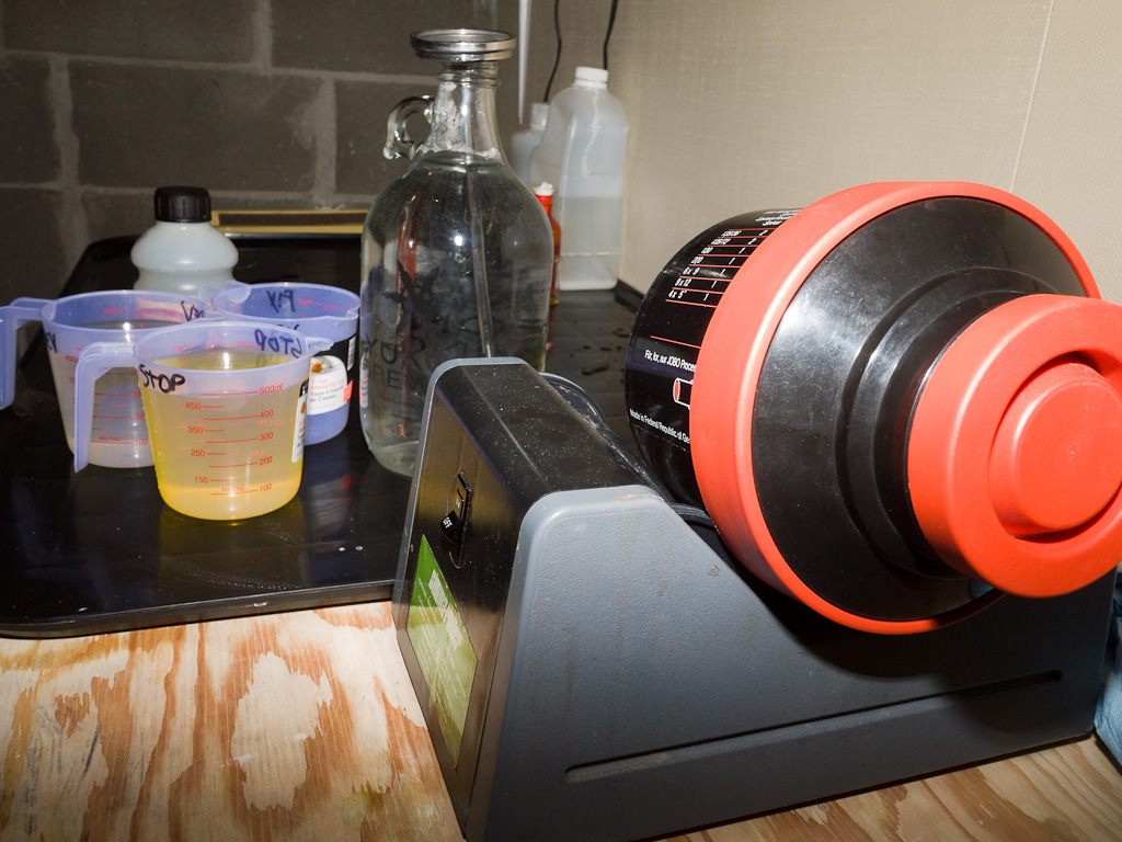

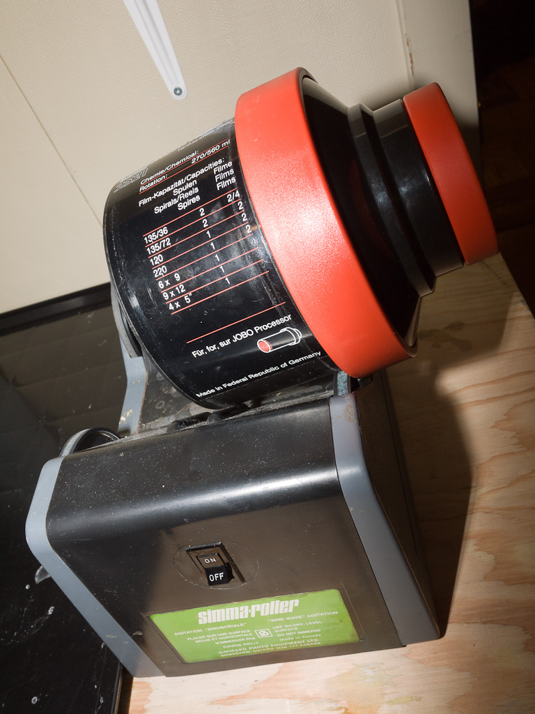

Just to update this thread I ended up going with a Jobo Multitank and 2509 reel, I use it on an old unicolor motor base and that seems to work well. I didn't like fishing around in trays with my fingers.

Jobo on a print roller base
Some pics of the little Jobo in action it works well on the roller base. I use 500 ml of chemicals just to have a little extra coverage due to the angle the tank sits at.
