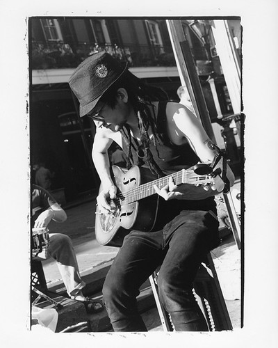

For comparison, this is a straight scan of the postcard that I sent out. They were all printed the same way.

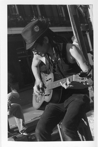

For starters today, I produced this image using filter 00 at 6 seconds, then filter 5 at 8 seconds. It's a little darker than I liked, but I had detail in the shadows like the musicians ear, and the architecture behind his right elbow.
This are all at f8 on the enlarger.

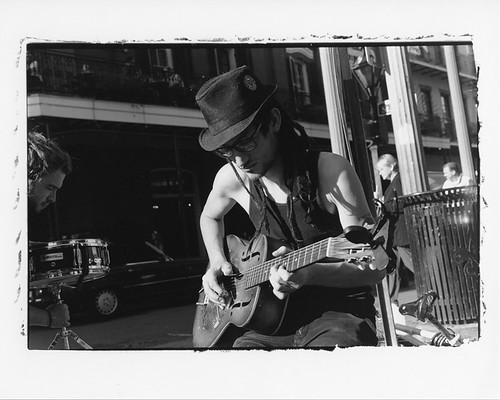

I thought the above image was ok, and didn't want to go on wasting paper, so I decided to try another negative. I produced this image using filter 00 at 4 secs, and filter 5 at 8 secs. I noticed that there was a little more detail in the texture of his hat, and I also noticed a little more detail in the architecture in the background. The building wasn't so 'blah' and the white on the patio ledge stood out a little more.

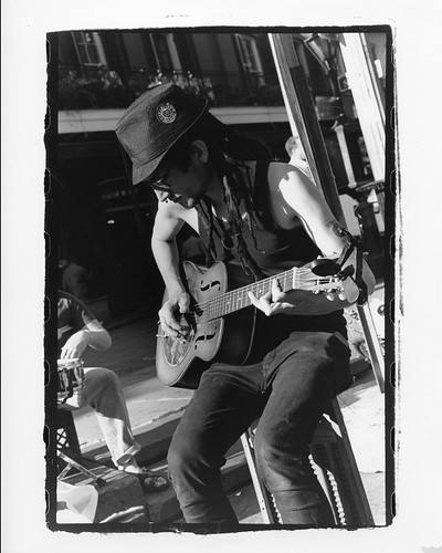

So then I thought "These two images were taken just seconds apart, and if it looks this good at 4 seconds, I wonder what the last print would look like at 2 seconds and 8 seconds. So thats what I did. I went back and reloaded the original negative and flashed it for 2 seconds with filter 00, and then 8 seconds with filter 5.
I noticed that the shadows in the background are much more opened up, but they aren't "blah" like they are in the post card. I've got paper white in there, nice blacks, and gray variations in between.
Music2003w by ChristopherCoy, on Flickr
I need to continue on this one some more because I am missing some detail in his hand that is strumming the guitar, which you can see in the post card image, so I think that I could probably use some burning there. I could probably dodge his ear just a little bit, and I think that I would also like to see the bottom burned just a tad more (around his knees). I'm sure that I would like a vignette a little bit as well.
I'd like to hear your thoughts, suggestions, or opinions on how I can continue to improve this image. Please, I'm begging you though, don't turn this into another split-grade vs straight printing argument.

I like the harsh contrast you achieved in the image. Although you are right, portions of the musician's arms are too hot. You might actually need to flash the paper for this.
As to dirty border, (I'm sorry for being direct) I think it's a bit weird. I would suggest filing a bit more so you can get a nice border all the way around the image. Also, the way it's reflecting light, it is creating a halo around the solid black area. To me, it looks strange. On the 3rd image, you may need to burn the second half guy on left bottom so he doesn't grab so much attention. Similarly, two guys on the right on the second image, I'd burn them in a bit.

Overall I like the straight scan as much as the split grade versions. While the last split grade version has real possibilities to be slightly better than the straight scan it might, as tkamiya has sa,d, need flashing to tone down the arms which are hot.
However have you tried to alter the grade by half a grade divisions at a time. You might find that there is a half grade increase and a slightly different exposure setting that gets you very close to the split grade version without flashing.
As you are experimenting anyway then this might be a worthwhile exercise.
I might of course not be a punchy print afficionado compared to those who have commented in the exchange. The straight scan is far from flat or grey in my opinion.

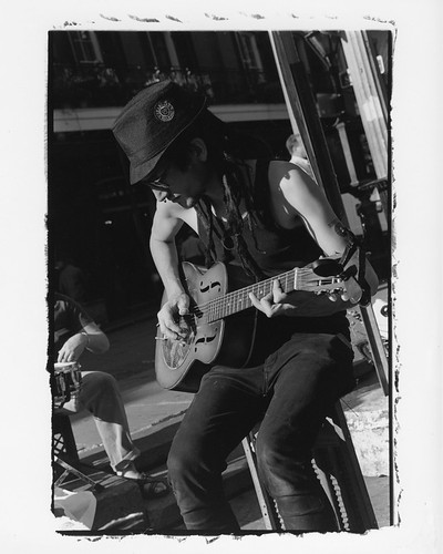

So I went back and filed out the negative carrier a little more. I was trying to avoid filing it to the point that I saw sprocket holes, but I guess I failed at that too.
This one was done with 2 seconds at a filter 0 instead of 00, and then i burned his right arm for +4 seconds. Then 8 seconds at filter 5, and I think I burned his arm in a little with filter 5 too, but I don't remember how much. Obviously it was too much.
Its getting better. I left my darkroom set up, so I'll try some more burning and dodging in areas in the morning.

I like it! Now it's clearly a dirty border!
By the way.... I don't like to think that you 'failed'. It was a "work in progress." That's what I think of less-than-perfect prints.

Yeah, I actually kinda like it. The sprockets bother me less and less as I look at it.

I like it! The dirty border looks good now, make sure to knock off any burrs with steel wool and if you have matt black paint, touch up the shiny edges now.
The final (so far) looks like it's printed down a bit more than I would have liked.
I liked the second variant, and would have only reduced the contrast from that print to make the arms a little less "hot" while holding the ear as-is.
