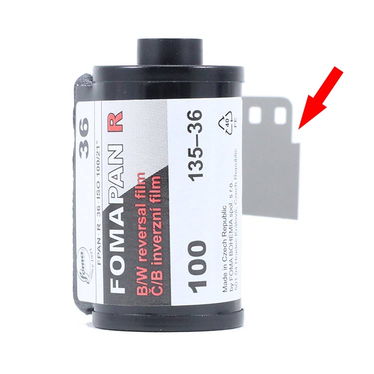

A quick way to spot a B&W film made by Foma, is to look for the leader tongue with the notch in it.
yes, that artifact is found on film FINISHED on the equipment used by Foma. but foma coated film might be finished by someone else. (I have gone through a 100 ft of Foma made bulk film myself a while ago, and the leader of the rolls I loaded did not look like that.
