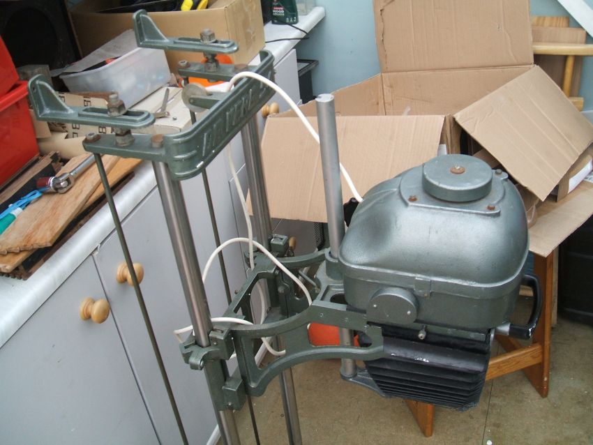

A couple of pictures of it after I put it back together:
Steve.

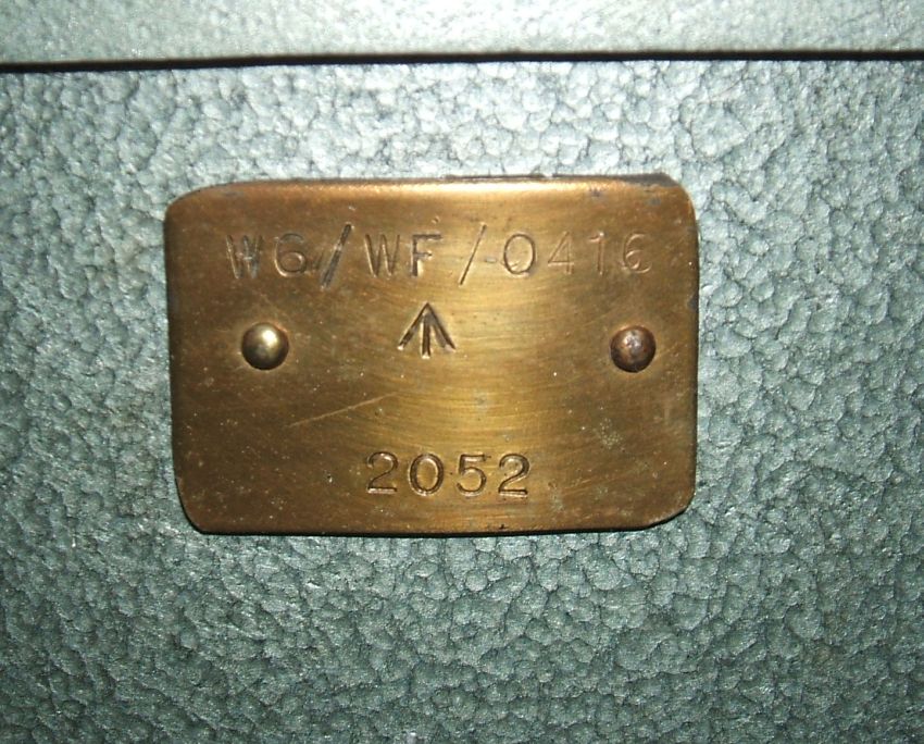

Steve, I paid ÂŁ90 for a new tube for the same head over 15 years ago, the things are hand made and hellishly expensive. You're better off making an LED head as you plan to and using the casing, it's bad luck the tube broke in transit.
I had the same enlarger in the 70's but with a heavily dampened Navy frame, used on board ships, but I converted the enlarger for horizontal use with a new frame and used the De Vere frame to mount a copy camera itself a De Vere monorail.
Ian
This one has a brass plate which looks like it has an MOD sign on it. I will have a closer look tomorrow.

Plate:
De Vere had the MOD contracts for enlargers which went to the Army, Navy & Air force. At one time the ex-MOD/Government surplus shops like A.W. Young, Harringay Photographic Supplies, Marston & Heard etc had many enlargers cameras etc, there were a lot of simple wooden 5x4 cameras as well as quite exotic offerings. They also sold off film & paper at bargain prices.

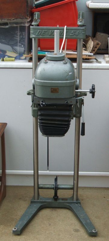

Here it is in my darkroom and fixed to the wall, waiting for its new light source. I had a day off work today - unfortunately the LED PCB is at work so it will have to wait until tomorrow. With me being the impatient type, I'm surprised I didn't go to get it.
I think the PCB will fit in the removable top half of the head quite easily. I'm wondering if I should keep the strange water filled diffuser or put something else there. Does anyone know how much water should be in it? When it is level there is a 2" x 3" air pocket in the middle of the image area. I'm thinking it should be filled up a bit more to optically couple the front and back surfaces but I don't really know how it should be.
I did put a 5x4 negative in, fitted my 105mm lens (I need to get a 135 or 150) and with a desk lamp held above I focused an image onto the baseboard (I told you I was impatient!).

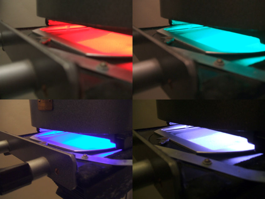

I now have the LED PCB in place. I don't have any translucent material here to use as a diffuser so at the moment it is using three layers of kitchen roll. It diffuses well enough but restricts the output a bit. I didn't have any luck with its original water filled diffuser. There is still sufficient to make a print with and I would have done just that if I actually had some print developer!
The picture attached shows the partially opened negative holder with red, green, blue and white settings. I'm not sure why my digi-thing rendered the green as cyan but in reality it is a really nice primary looking green. The blue is a lot deeper than shown here too.
Steve.

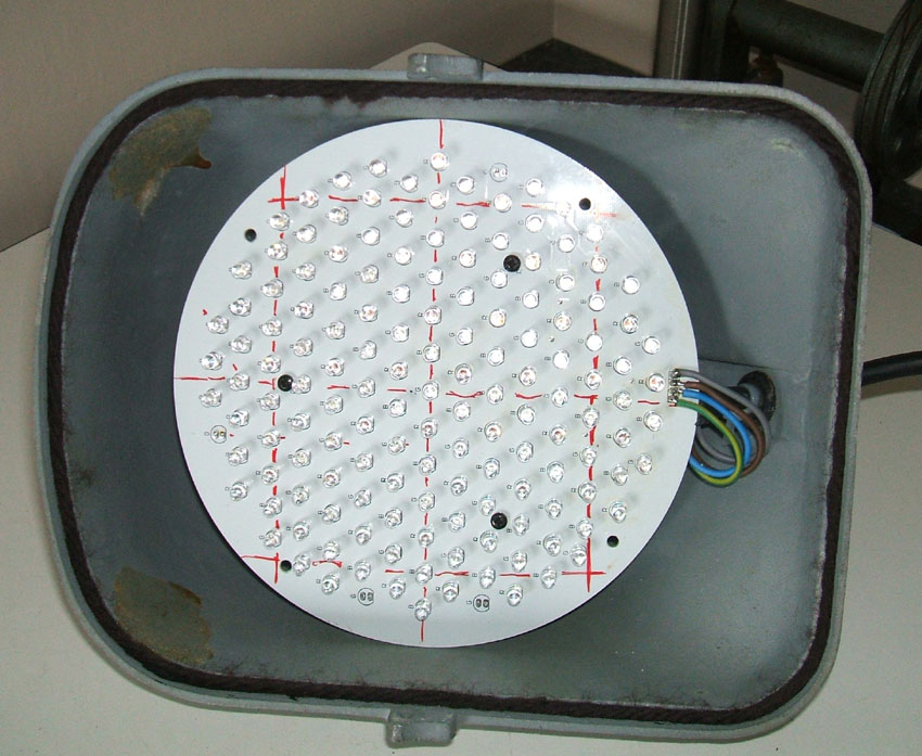

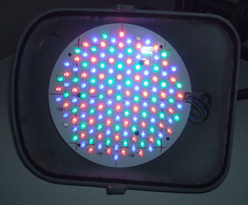

Lets see a picture of the LED PCB. Is there some kind of controller with it? Power supply?
Some views of the PCB with LEDs off, red, green and blue on and just red on. The PCB has a common anode connection and red, green and blue cathode connections. I have a four wire cable going to a three gang, four position rotary switch which gives the options of red, green, blue or all three colours together. The PCB has current limit resistors so I just use a basic 30 volt DC power supply. each colour draws around 120mA.
Steve.

Ok, so that is from a LED stage light. Looks like a fantastic fit!
I guess there would be a lot of ways to hook that up, from a very complex closed-loop, PMW system to simple toggle switches for the colors. What are your thoughts on the hookup?
Just a guess here, but I'll bet it will give a better light distribution with a diffuser that is thicker in the center. The bottom plastic plate diffuser of a Chromega mixing box comes to mind.
Also, I'm curious as to how the exposure times will be. I'm still skeptical about LED intensity.
