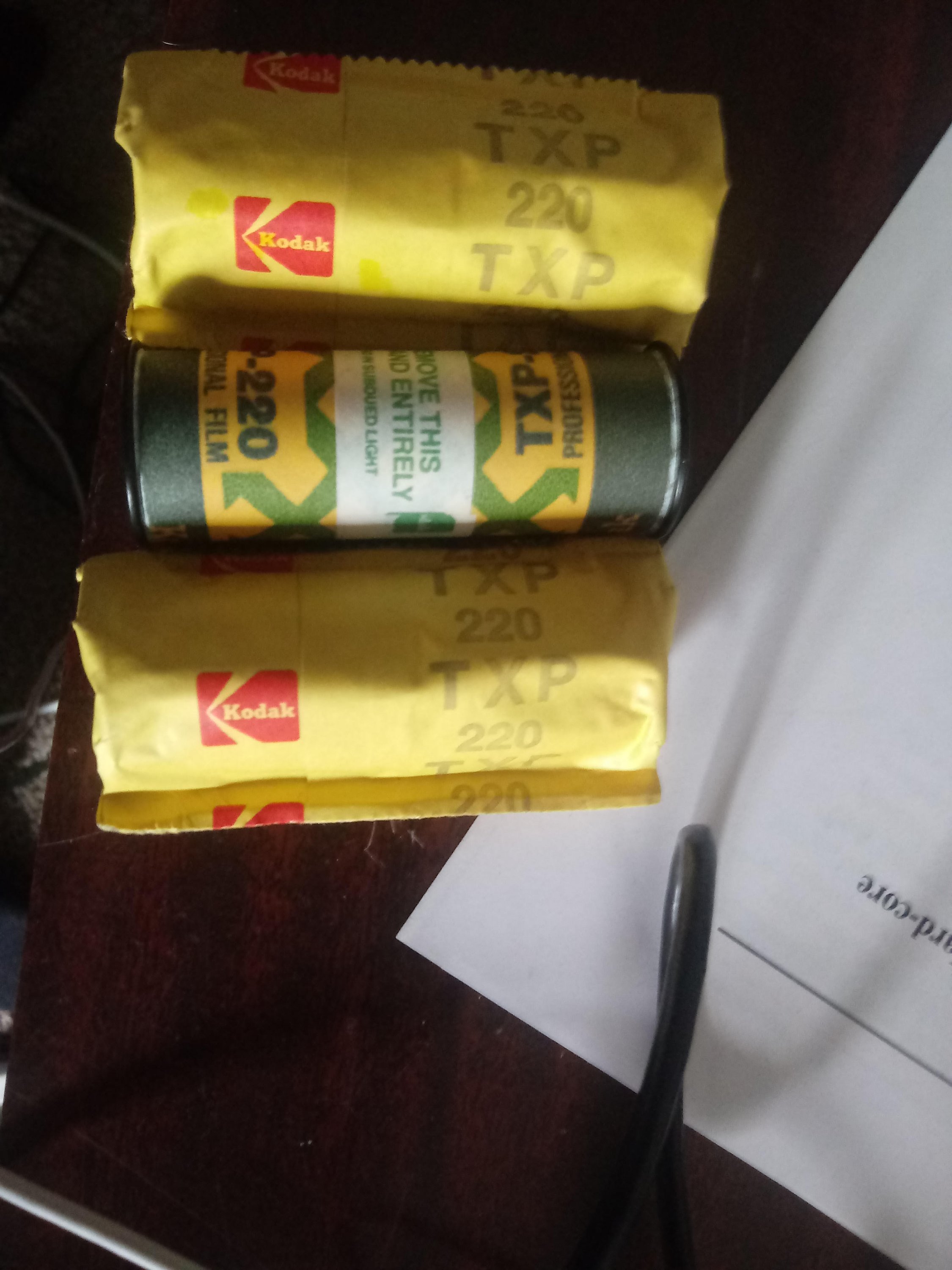

Out of curiosity, how exactly is the film "badged"? I'm wondering if the film is old enough that the 1999 datasheet should be used (5.5 minutes) rather than the 2007 datasheet (4.75 minutes).
I have the box, but the expiration was torn off, but I remember the seller indicated the film probably expired in the late 80s to early 90s. I don't have the box with me right now, so I also can't reference it.
That appears to be the Tri-X Pan Professional referred to here: https://125px.com/docs/film/kodak/f9-Tri-X_Pan-199906.pdf
So definitely the 5.5 minute recommendation.
My apologies for not asking about the "vintage" earlier, because my first advice probably ended up misleading you.
The newer, 4.75 minute stuff is badged Kodak Professional Tri-X 320. You can see the difference in the wrappers in the 2005 version of the datasheet f4017: https://125px.com/docs/film/kodak/f4017-400TX-2005.pdf
