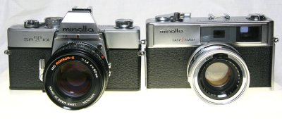

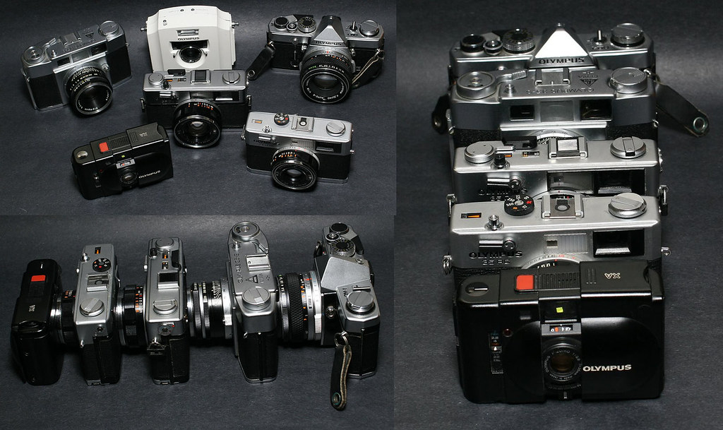

But 7s it's quite bigger and heavier and maybe closer to my Minolta srt
Here is an SRT-101 and Hi-Matic 9 (similar to the 7s) side by side:
Here is a photo with some of the Olympus rangefinders and an OM-1 for reference:
The 35 DC in the middle is about the same size as the 7sII and G-III QL17.

Maderik,
You have a fantastic set here, you must have fun :smile:
OM 1 it's a bit smaller than my SRT 101 and about a half lighter!
Minolta 7s has even a bit higher body then srt 101.
Olympus RF are quite small and light, i like that about them.
Thank you very much for showing me this, I appreciate it!
