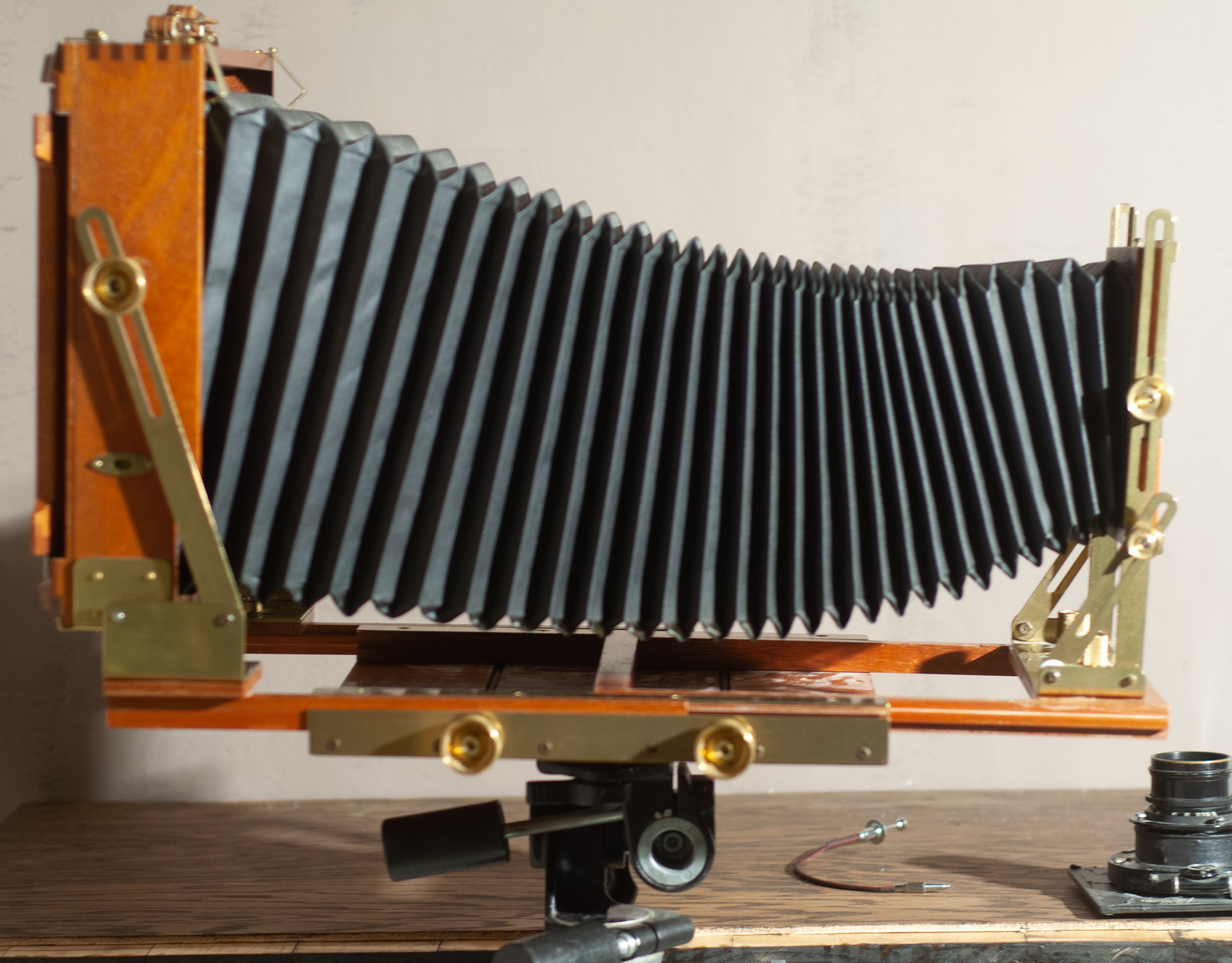

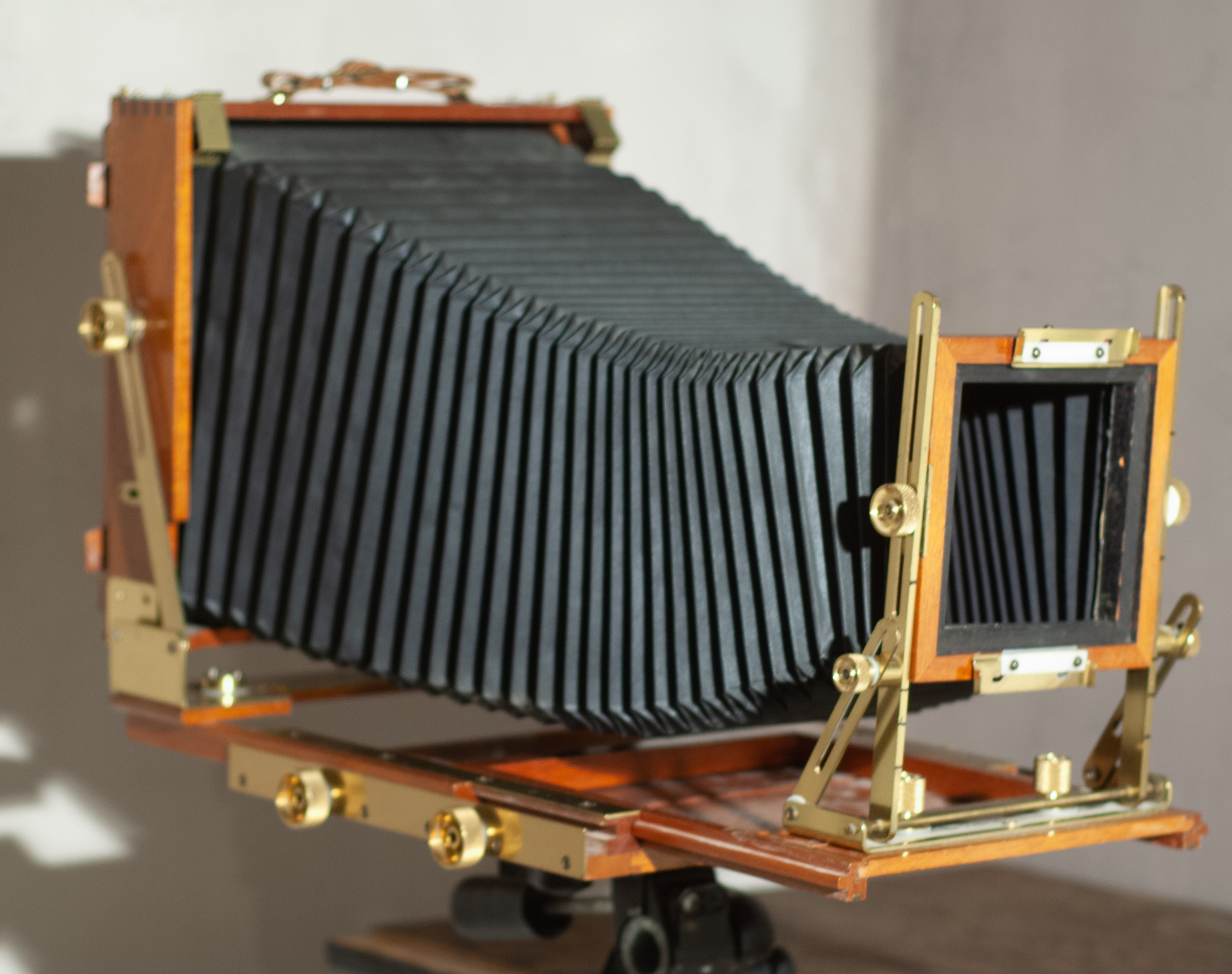

Pics sorry no attempt at art

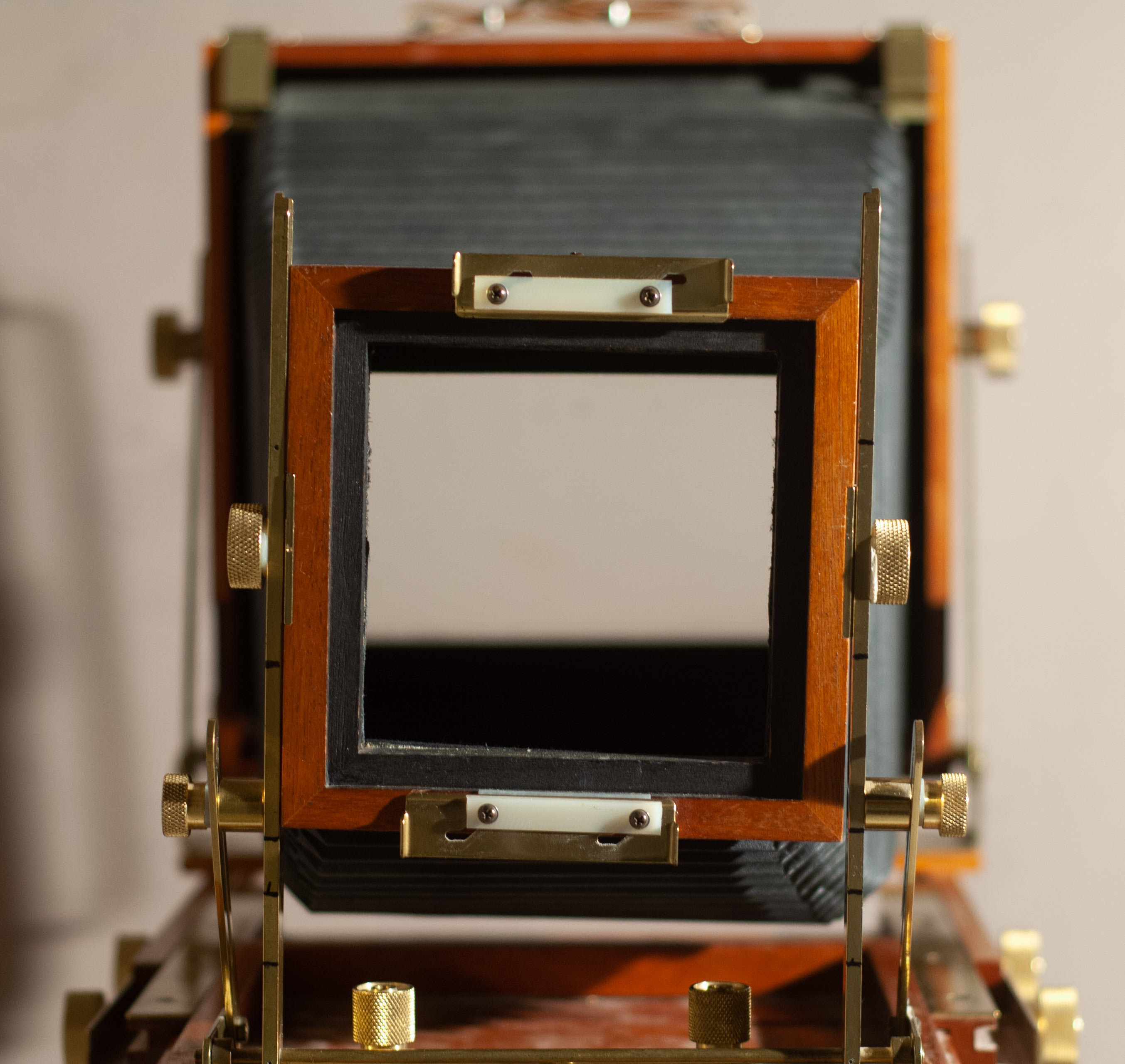

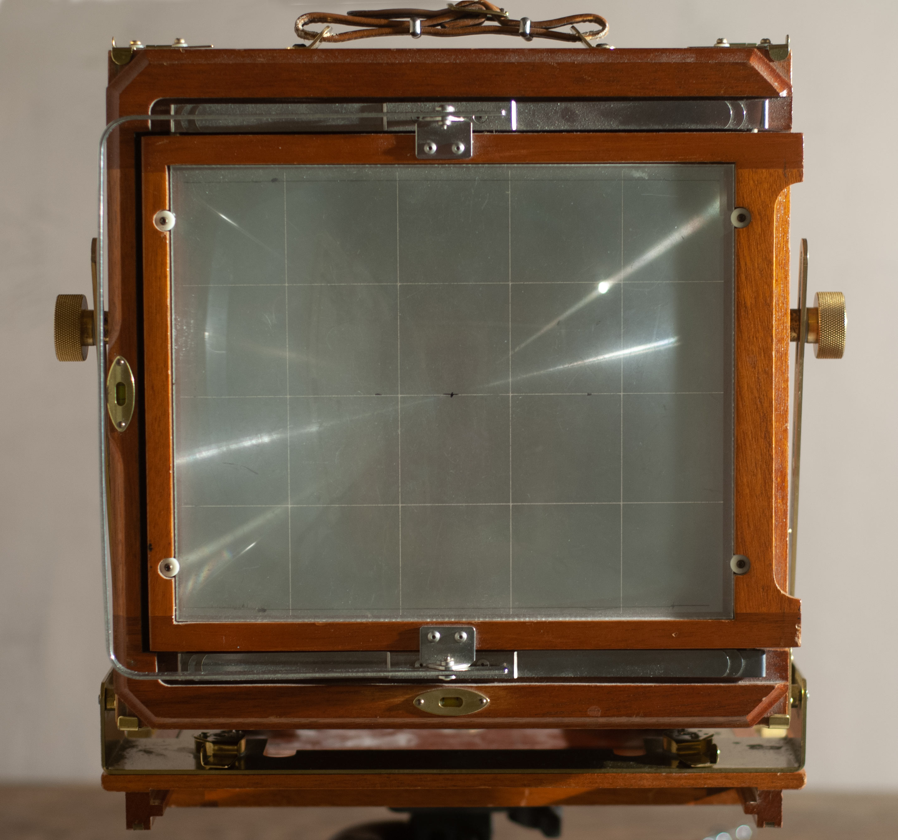

guess my jpgs are too big

That looks to be in decent shape. I can't recall seeing those little pins (probably screws) and small washers as ground glass retention before. Is having a bail lever on the back a divisive thing amongst large format folks? When I see it, it makes sense to me, but I've never personally owned a camera with that feature.
MarkS
Mar 12, 2004
545
That's a Vermont-made Zone VI. Richard Ritter made it, he can repair it.
