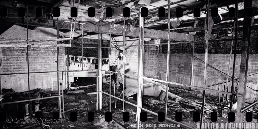

There's certain looks that get me excited about 35mm, often rare films that contain much grain but are pleasing, or just aren't available in other formats, for example this...
Fuji Neopan400 EI 800 in pushed to 800 in Rodinal.

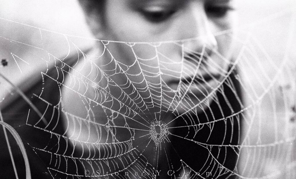

Or this...
Kodak Double-X EI 200 but pushed to 400 in Rodinal
