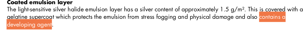

Something interesting happened on today. I made an experiment with reducing sugars, which are a kind of sugars known to be able to reduce certain metal ions (i.e. Ag+) through their aldehyde or alpha-hydroxy-ketone groups.
I made a solution of sugar and lye as follows:
- Table sugar (sucrose) -> 20grs
- Lye pellets (NOT anhydrous, they clump. I can't measure how much water there is in) -> 16grs
--> Into 50ml of tap water.
I made tests and it "proved to be a developer, with poor shadow density but rendering all detail".
I thought I had found a replacement for Vitamin C in my Rude Rodinal but...
Then I remembered:
(This comes from the Ilford datasheet for my KENTMERE VC deluxe RC paper)
You couldn't believe how I felt.
I made another test, using a heavily fogged paper strip and I used as "Developer" a plain saturated solution of lye pellets. I knew if the developer in the paper was of interest I just had to activate it. It worked.
