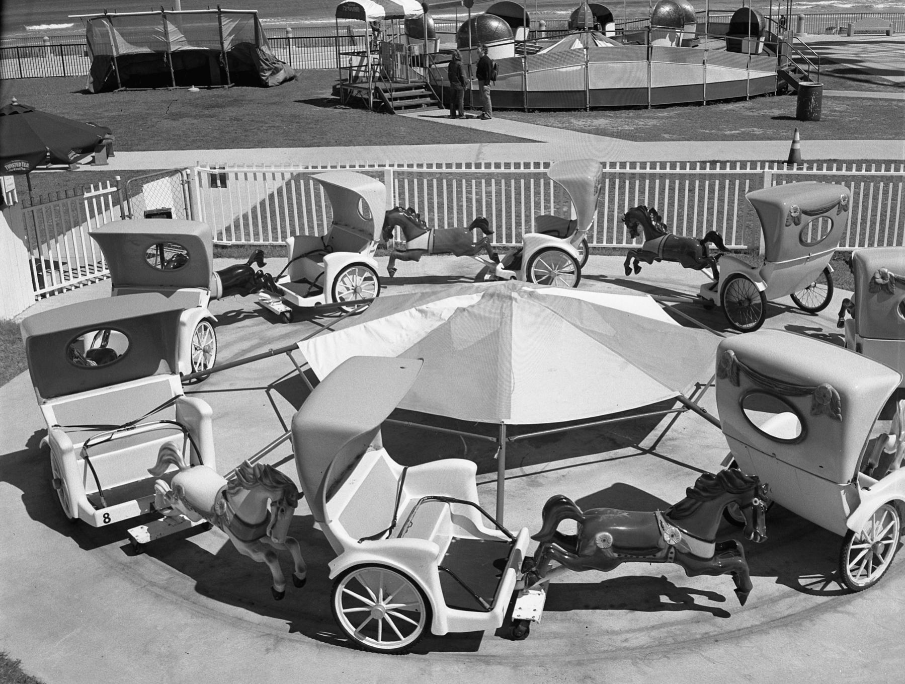

I made my peace w/ 6x4.5 when I had an old 1938 Zeiss Ikonta folder of that format that was absolutely tiny, and had one of the best Tessars lenses (uncoated) I have ever owned. Great little $40 pocket medium format camera. I would put shots from it up against a Contax any day (see shot below & sorry about the Newton rings). Newer is not necessarily better when it comes to IQ, especially for B&W work. Even better was my old 6x4.5 Voigtlander Bessa 66 folder w/ a Heliar lens.

Well, whatever camera/lens/developer/technique you may have used in the photograph of the carousel, the result seem almost liquid and may simply slip off the page! It is simply splendid. Perfect! If it is the old Heliar, I have seem some of these old Heliars that have that effect and the ability to produce these wonderful images. Hang on to whatever it is... it is is spectacular!
Aha! a re-reading reveals that it is an old Tessar and they too can produce wonderful images... great working old lens!
