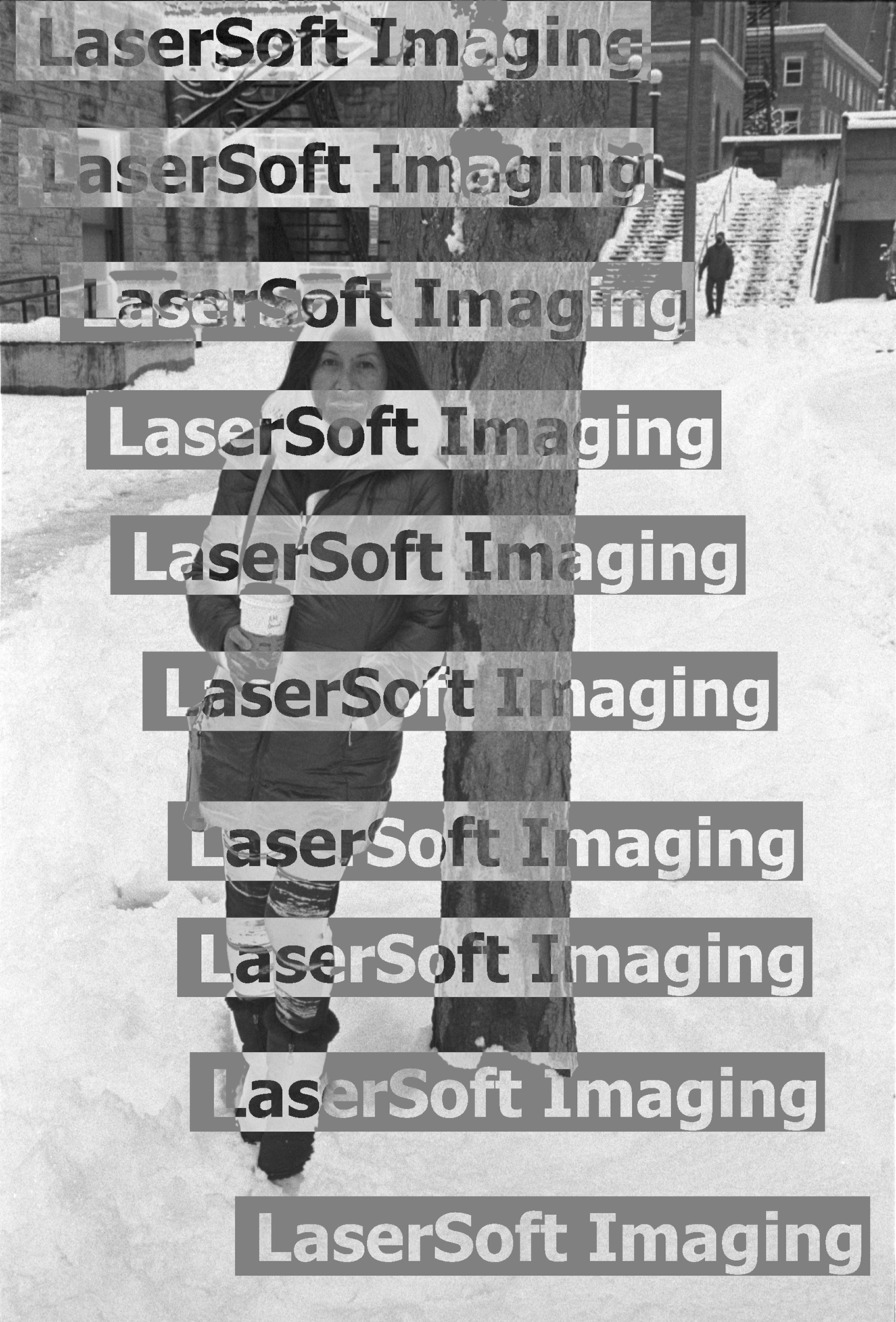

I finally get the Silverfast demo version installed and played with the interface: A better interface than Hamrick by far. Then I scanned an image to see what Silverfast can do:
Utter and complete fail: You would think that the company that wants to sell you its software would let you see what it can actually do
without destroying the output with stupid watermarks.

I agree with your issue about the size of the Silverfast watermark. It also annoyed me. Like you, I think that this watermark obscures too much of the image. In contrast, Vuescan just superimposes wording that effectively conveys the point without totally obscuring the image.

Just scan at the highest resolution available on your scanner. The watermark should then be relatively smaller. At least old(er) Siverfast demos were like that...
