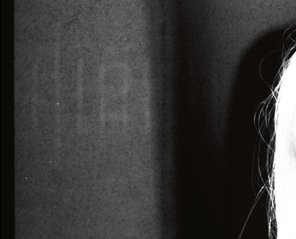

I've had lots of strange spots on 20 rolls of tmax 400 in 120, emulsions 153 154 and 155. I've been looking for the cause in my development, but today I made a scan which makes me believe the film is the problem (or one of them at least).
In the upper left of the frame (#1 on the roll) there are vertical lines which can also be found on the backing paper. Whats wierd is that the number 2 is superimposed, which means it's offset through the paper. What is causing this?

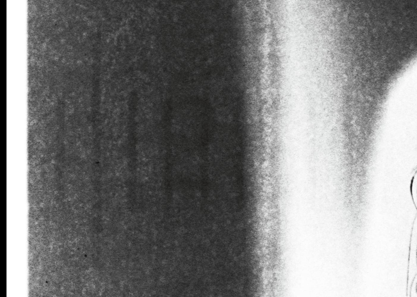

The frame also shows the spots/mottling or whatever, seen on all rolls. The background behind the number 2 is supposed to be smooth. Strangely the spots are plus density in one batch, but minus density in another. The negs range from useles to barely noticable spots.

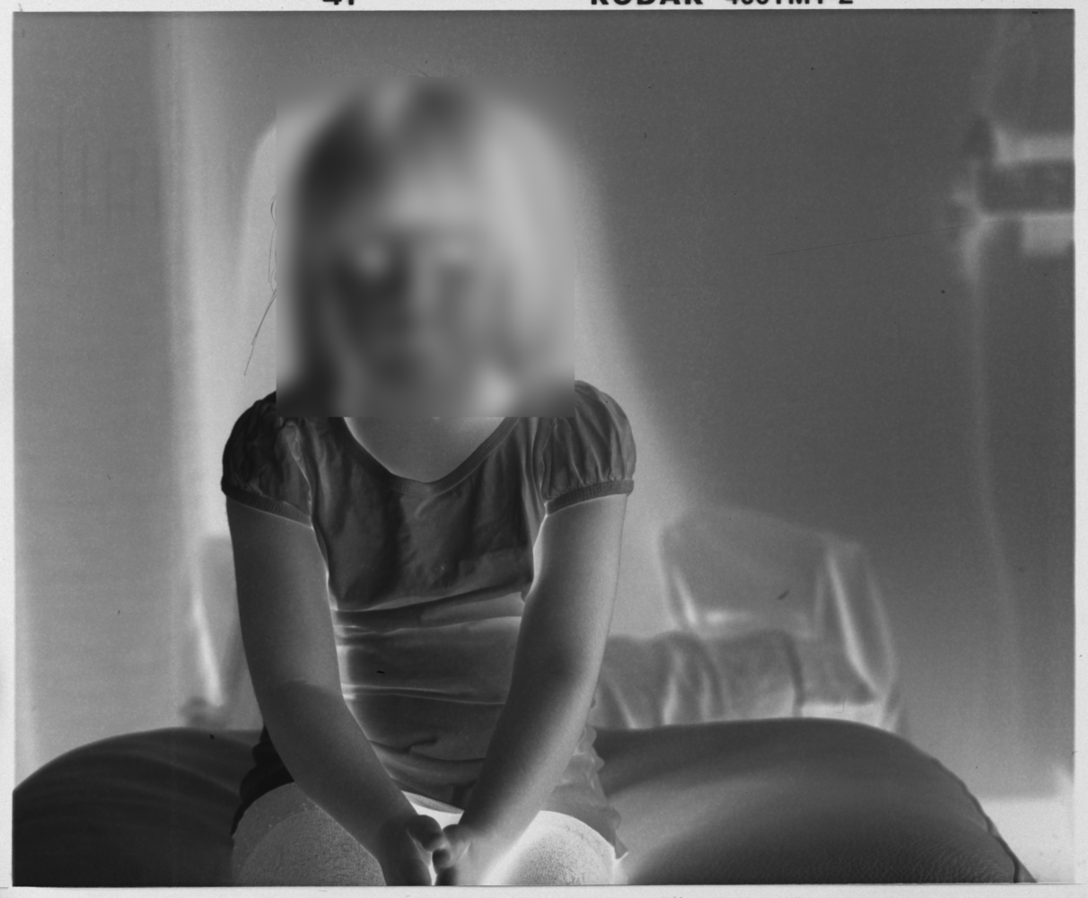

I'm trying to post an example scan from one neg, emulsion 155002. (face is blurred, not a defect)
mamiya rb67 180mm, xtol 1+0.5, jobo 24C cont.ag., 2m prewarm, filtered chems from tap water, water stop, ag fix, photoflo 1+400
films not frozen or refridgerated, shot within date, developed days to months after shot
It strikes me now that on this roll the spots are thin, but the offset is dense.

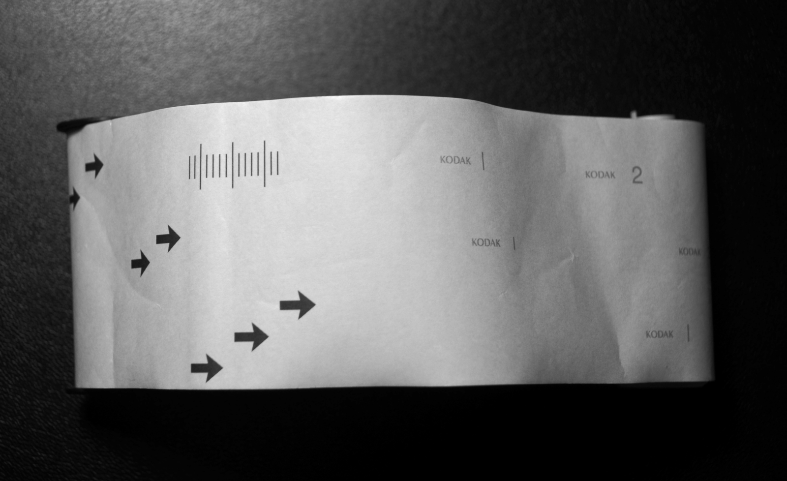

I just dont understand how the print on the paper can affect the film from both sides. When you roll the paper on the spool, the "2" and the vertical lines line up on top of each other with film in between. But the "2" is turned away from the film and does not touch it at that spot!
I don't think anyone knows for sure what the cause is.
Something would have to pass from the print through the paper and onto the film base. Heat? Radiation? A chemical substance? Moisture? And it gives the same effect (higher density) as the print directly touching the emulsion side.
But is it before or after exposure?
Very well observed and a very interesting point that you make. It would mean that the added density in these areas cannot be a result of a chemical reaction triggered by direct contact of the ink and the emulsion, which has been the most common explanation of this problem to date. Now, after seeing this, one thing comes to my mind: Luminescence? Is it possible that the ink contains some kind of substance that actually emits light (or some other form of radiation the emulsion is sensitive to)? This would explain why the film has seemingly been "exposed" from both sides, front and back. And, if the assumption above is true, will the ink emit light all by itself (so it is merely a question of time until the added density shows up after a couple of months of storage) or is this process triggered by some form of exposure to external energy (heat, x-ray, ...)?

I have no idea what's going on wrt chemistry/radiation, but I'd like to point out that the emusion side of frame #1 is touching the "2" ink marking on the unexposed roll and the vertical lines on the take-up spool after exposure.
You're smarter than me. I just now played with the paper and spools and realized the same thing.
And that means the marks show
up both before and after exposure. If thats relevant.
That puzzles me too, you got both marks on the same neg. Do they use radioactive inks or something?
It probably is because the film touches different parts of the backing paper before and after exposure.
