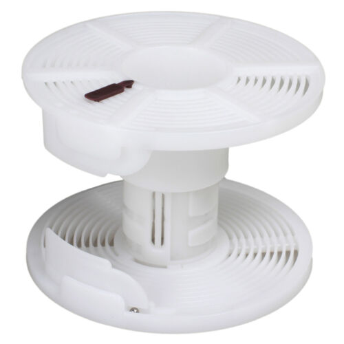

You could do all that or just get one of theses.
