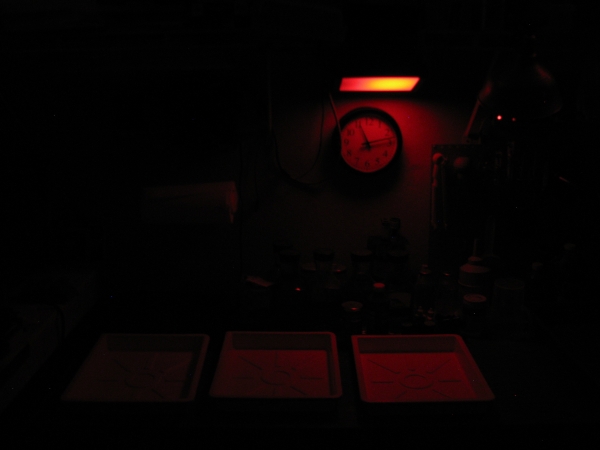

One amber colored safelight makes a darkroom pretty bright. If you get a couple or three of them, after a while it seems like daylight almost.
Hello Jack,
Here's a pic of my printing area with nothing but the safelight. Note that you can easily read the clock on the wall.
