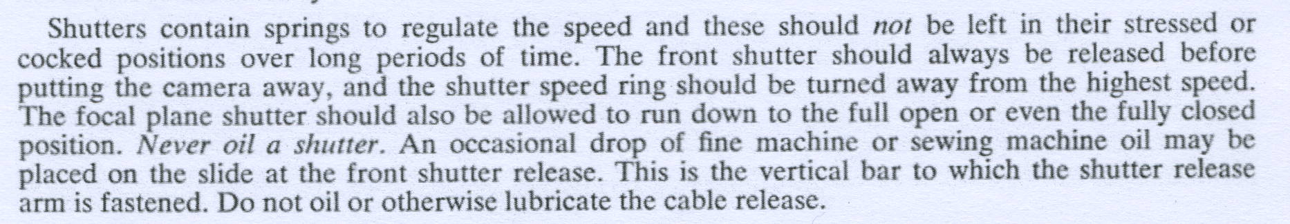

Thanks Steve -- I just checked my Speed Graphic -- and yep, there was tension on the focal plane shutter. Now released (after years of being under tension). It is a little relunctant to go from 1.5 to T and T to 0. Should one set the spring tension at any particular setting during non-use (mine has 6 spring tension settings)?
Vaughn
From Pacemaker Crown Graphic and Speed Graphic Instruction and Reference Manual page 31 see attached.
