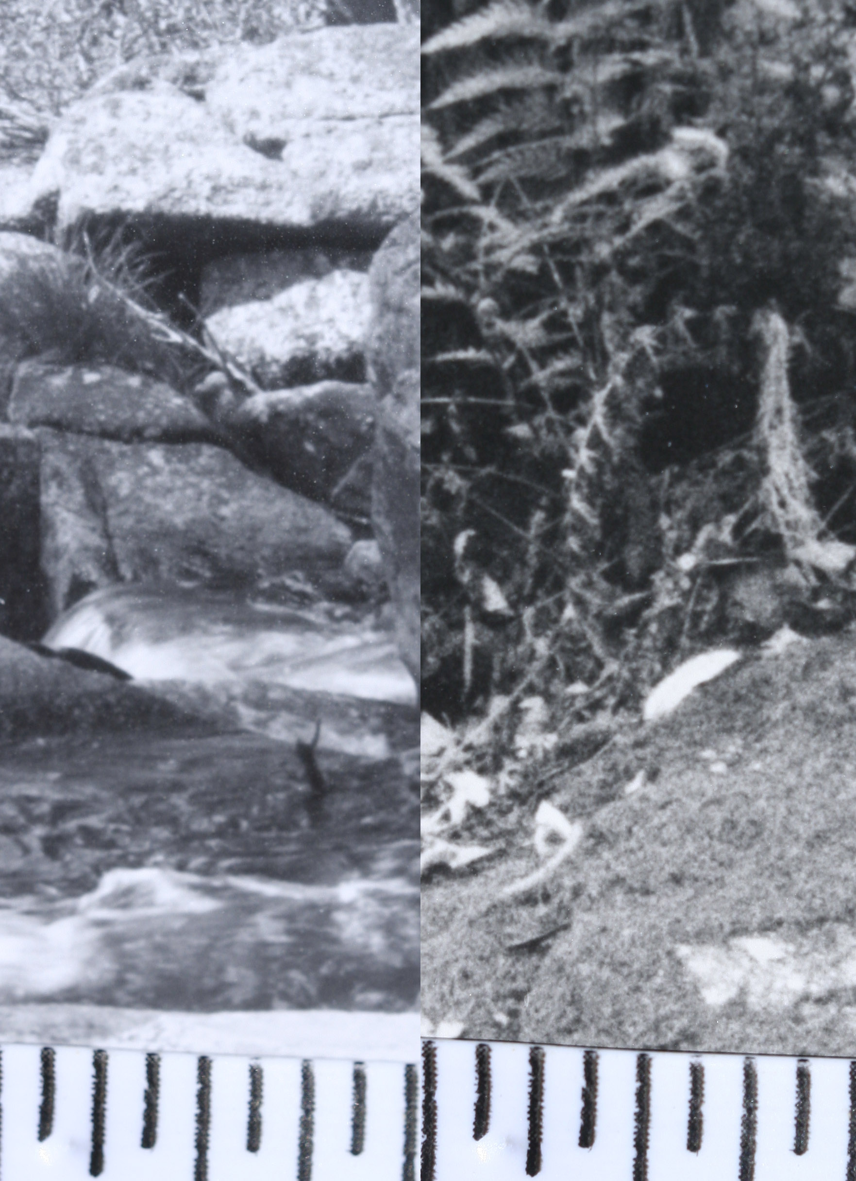

What you see here is the very best of my 35mm pitted against the very best of my 4x5. They are, to me, identical. I prefer the 4x5 for many reasons that are more emotional than demonstrable. Yes it's a fine-grain film in 35mm up against a fast film in 4x5. But that is how I operate.
I first introduced this image in a thread, 35mm enlarging - who is passionate about it?. In that thread, and in many other discussions, Thomas Bertilsson convinced me that 35mm is a valuable and viable format for photographic expression.
He didn't change my mind. But he did expand it. As I've said, I prefer 4x5 and I wish I'd used 4x5 more often in my youth, because most of my vintage photography is 35mm and I enjoy printing 4x5 most of all now. But Thomas Bertilsson convinced me it hasn't all been wasted time.
All I can say in response to this, is that our realities are markedly different. Perhaps we exist in parallel universes where the laws of optics and physics are different. That's my best guess.
Try not to allow yourself to be drawn too far off center line and into the weeds, Frank. Nothing has changed. The sun continues to rise in the east and set in the west. This fact is easily verified by simply looking at it with your own eyes.
