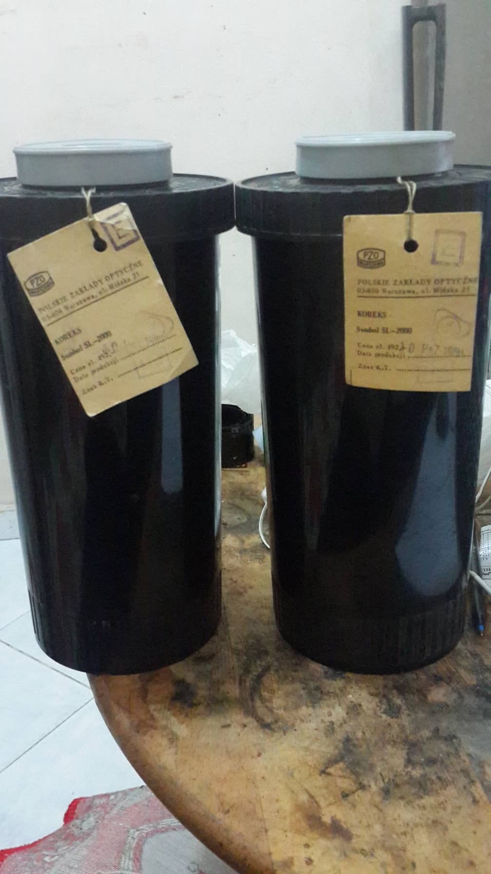

I have another Polish tank that hears five rolls at once, Corox, but it is actually an evil tank that consumes a lot of chemistry. If you want to develop two rolls together, you must use 700 ml chemistry,,
While that tank that I am looking to prepare and repair, it consumes less than half a liter only..
I'm confused. Two rolls in 700 ml is better economy than one roll in 500 ml. Further, most 35mm stainless tanks only need 250 ml for a 35mm roll; I can do 35mm in my Paterson plastic tank in 290 ml (and two rolls of 120 on the same spiral in 500 ml).
I apologize to you, brother, I made a mistake in the ambiguity.
The Polish tank is large and can develop five rolls at once. If you want to develop one roll, you must bring 400 ml, and if you want to develop two rolls, you must bring 700 ml.,
While the stainless steel tank can develop one roll using 280 ml, and if you want to develop two rolls, you should bring about 485 ml (just under half a liter).
So the stainless steel tank is very economical and this will make me save some money.
for example ,,,
If I prepare half a liter of developer (C41), this quantity is assumed to be able to develop six films.
If I develop the first batch, which consists of two rolls, there is definitely a high probability that the liquid quantity will lose a little of its mass as a result of evaporation and as a result that the emulsions have little liquid attached to them, if you put the developer into the tank and then empty this The developer will definitely not get the same amount (500 ml), you will definitely lose at least 5 ml.
Is this logical?
Yes, it is logical.
- If we want to repeat the process and develop two more films with the same developer.. we will also lose an amount of no less than another 5 ml.. and therefore we will get the net amount to become 490 ml..
And if we want to develop two more films..
Here we should pause for a moment.
This is the moment of truth.
We want 485 so we can upgrade one last time before we get rid of this developer.
- If we were able to develop six films with a half-liter, this is considered a success for us, since we do not have a rotary machine, we work using traditional manual development.
I hope you get the idea clearly.
All these are the reasons that made me want to get that offer so badly.
You can't do the same with the Patterson tank, why?
First, the Patterson tank needs 290 ml per roll.. I mean, it needs 580 ml in order to develop two films at once, and this means that you should prepare a full liter and not just half a liter.

@mohmad khatab That makes perfect sense, I just hadn't caught that one of your tanks was a Paterson type and the other stainless. That's about what I'd expect, then. I do two rolls of 120 in my Paterson with 500 ml, but that's by loading the rolls end to end on a single spiral.
Either way, I'll stand behind the suggestion to use the design I linked above -- if nothing else, to test the fit with standard PLA before spending on an upgraded filament. There are black PLA and PETG filaments (printable with nearly any machine that has a heated bed) that are opaque enough for this, and PETG is chemical resistant (the same basic plastic used in drink bottles, with a treatment to make it print better). If the lid doesn't fit your stainless tank, then print the entire tank in black PETG -- cost should be almost the same as PLA, and it'll work for your need. The design is sized to take stainless reels, so should use the same amount of liquid.
That manufacturer is wellknown, but I did not know that they made tanks too.
A single-reel Jobo tank from that period even took 750mm. BUT this was for the reel in extended state.
If your reel can be extended to 60mm, you could use less fluid when developing just one 35mm film. Check this.
Concerning your leaking tank the best option to my mind would be to somehow get a new cap as spare as described above.
Concerning a makeshift sealing you might try a painter's masking tape, the extra-deep corrugated crepe version for roundings, to get around those knuckles.

Developing one film needs 400 ml in this Polish tank, and if you want to develop several films using a successive development plan, meaning that you develop one roll and then develop another roll and so on, this is what I am doing now, and this Of course, it takes a lot of time, effort, blood and tears in order to save chemistry and money.
- And two weeks ago, I was complaining about this matter and an old man who works as an ophthalmologist came to me, and he is one of the old amateur photographers, and he brought me a stainless steel tank with two reel 35, and another reel outside the tank measuring 120 m Unfortunately, the tank cover was damaged.

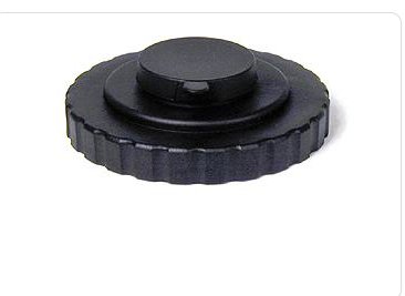

There are designs on Thingiverse for a complete developing tank for stainless type reels (that is, without a core). It might be simpler to print the complete tank (resized in the slicer to fit the reel(s) you already have) than to find a downloadable file for the pour-through lid and inversion cap to fit your existing stainless tank. I'd recommend printing in black, not the red used for the example print for the link -- I presume they used red for visibility...
Brother Donald.
Do you know,, Where can I find the 3D printing file for this single cover?
Without precise dimensions, you can't find that cover. The diameter that fits to the tank body is critical, and without knowing that, no one could produce one of those in CAD or print one with any likelihood of it fitting. If you have the necessary measuring instruments, whoever you know who has a 3D printer can probably draw one up in whatever 3D CAD software they're used to using.
Thank you, brother, for your kind reply.
But my friend, I don't know anything about design applications.
I am a simple man, my experience in these matters is very limited
This cover is very popular because it is the famous stainless steel tank cover.
Even "standard" stainless tanks vary in diameter. I have a couple, one leaks when I put the other's lid on it. You need to find someone who knows enough 3D CAD, let them measure your tank and show them what the lid needs to do (pour-through light trap, place for an O-ring to seal the lid to the tank, inversion cap to prevent the contents getting away when you agitate), and pay them to do the design work. Even then, you'll get a lid that will probably only work on one brand of stainless tank.
One solution to seal a leaking cap or lid might be using a strongly crinkled, wide masking-tape for painters. It could be formed enough to adapt it to more complex forms.
Or, though messy, use some kind of children putty.
