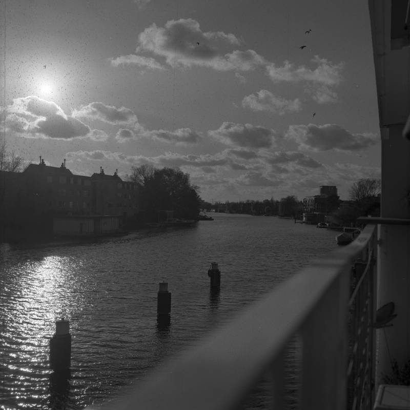

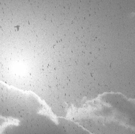

I give up too...
Tried my first Foma T200-120 film last week. Very careful with the emulsion, no stop bath used (only water). Still highlights littered with 'debris' (not dust, not birds).
Add that to this: (there was a url link here which no longer exists)
... and I give up on Foma, in 120 at least :sad: Never had problems in 135 :smile:

I wonder what you do with those films... I use Foma all the time, both in 120 (Fomapan 100, 400) and 35mm (100, 200), I don't remember having a problem. So, I guess, I am not giving up.

I've only had one problem with random specks on Foma, and that was because my Fixer had loads of silver(?) flakes in it, visible to the eye even, scratching the film.
The accordion-bottle I had, had accumulated a lot of fixer gunk trough the years and it had started to come loose after I blended a new fixer and messed around with the bottle a lot. (causing scratches as well as embedded silver(?) specks in the emulsion.)
After I blended a fresh fixer in a new, clean, bottle, I haven't seen anything similar.
Have you tried filtering your fixer lately, to check for foreign elements? (the emulsion of Foma is quite soft).

I stoppped using accordion-bottles a long time ago. The fixer I used had seen only a couple of films and should not at all have been able to hurt the emulsion (though it might have).
I've spent a lot of time trying to get Foma 100-120 to work without scratches, everything to no avail. Foma T200-120 has therefore hit my patience limit straight away.
That's not to say that Foma films are crap. Lots of people use them to perfect satisfaction. Just not me one of them, apparently.
I will stick to Kodak and Ilford (and to the loads of Fuji in my fridge/freezer). Love(d) Neopan 400 in Rodinal :heart:

I have used exactly two rolls of Foma 200 in 120 format in my life, and both of them had exactly the patterns in the emulsion that 'sandermarijn' shows above.
On the other hand, I have used at least 100 rolls of Foma 100, and at least 100 rolls of the 400, and they have all been perfectly fine. Foma did acknowledge problems with the 200 speed emulsion a while back, and they pulled the film from their product line to reformulate it. It was re-released earlier this year.

About Foma, perhaps the combination base type/emulsion/back paper for 120-film in relation to mechanical pressure is a very deep problem in their production procedure. Perhaps based on older parameters, that requires very radical changes in order to cope with the obvious problem they have with 120-film. If a lot of people working with the most leading brands of middle format cameras have the kind of problems you have made obvious, Foma have a serious quality problem with this product. And, no doubt, they must realize that, but perhaps not easy to correct.
We may hope they make sufficiently good business with their other very high quality products, such that they are able to correct for the 120-film. Or they conclude being content with supplying quite cheap film for people with middle formats old folders – but I doubt that!
BTW, in view of there being many people using the film without having OR seeing this problem, perhaps the best policy for the company is to keep quiet and doing something about it, rather than announcing fault with their product – it seems to have happen before by big companies! Just a suggestion.
That's one of the things I don't get: why aren't many more people reporting problems like the one I have? I tried two batches of film, both showed the issue. I tried several cameras, all of them showed the issue. An APUG-member from near my place shot (in his own camera) and processed one my films, which reproduced the issue.
Am I extremely unlucky with the film batches that I buy? Am I too critical and do most photographers not feel so bothered by the defects? These are questions I am left with.
