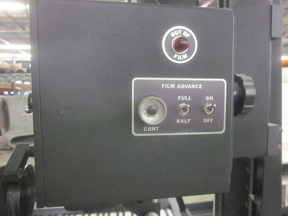

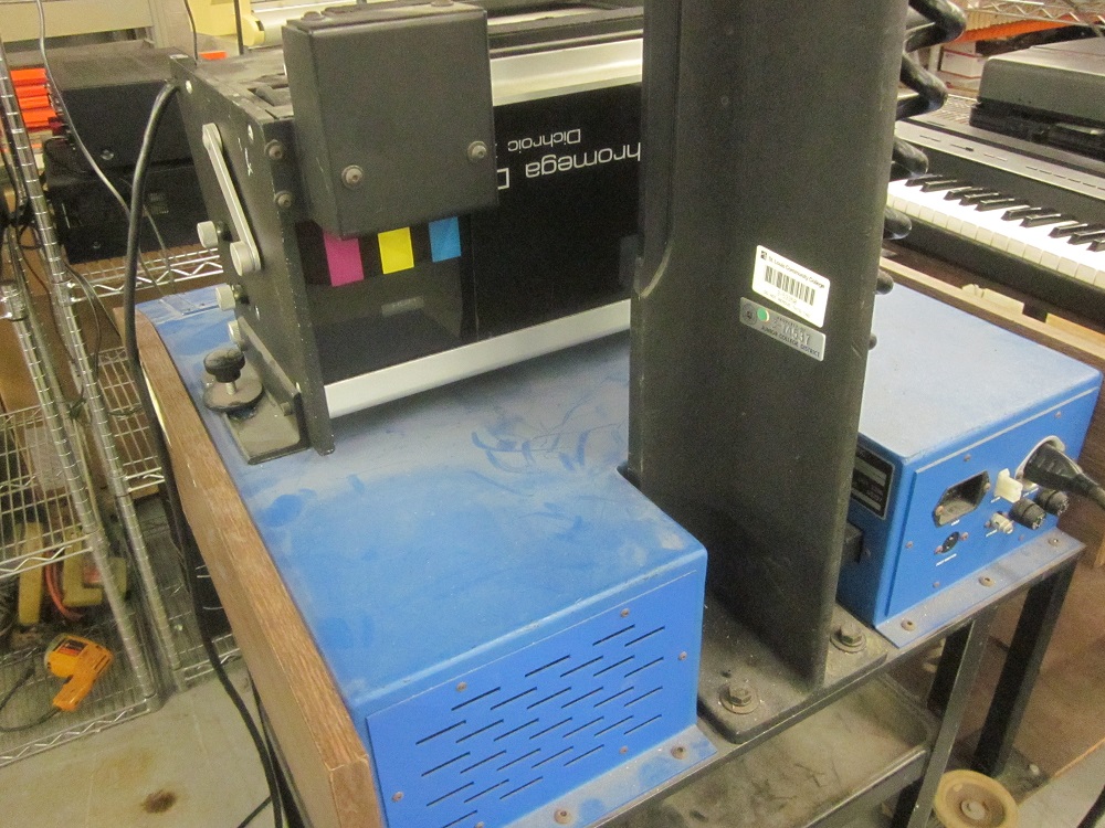

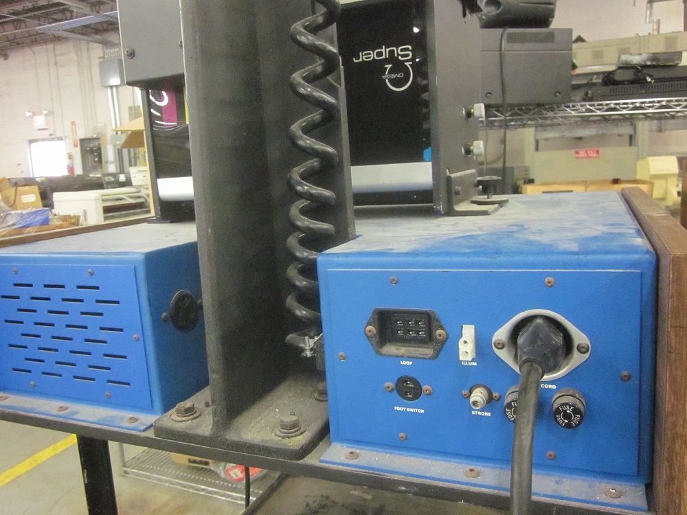

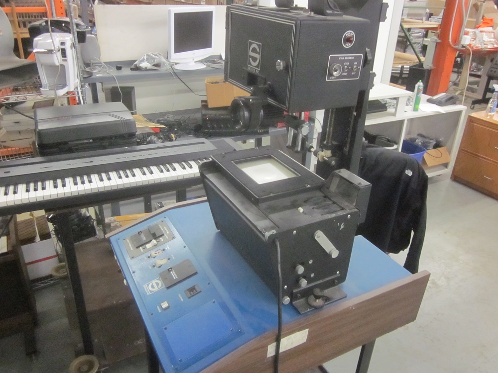

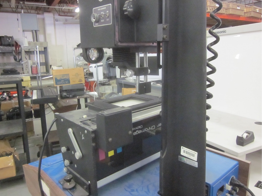

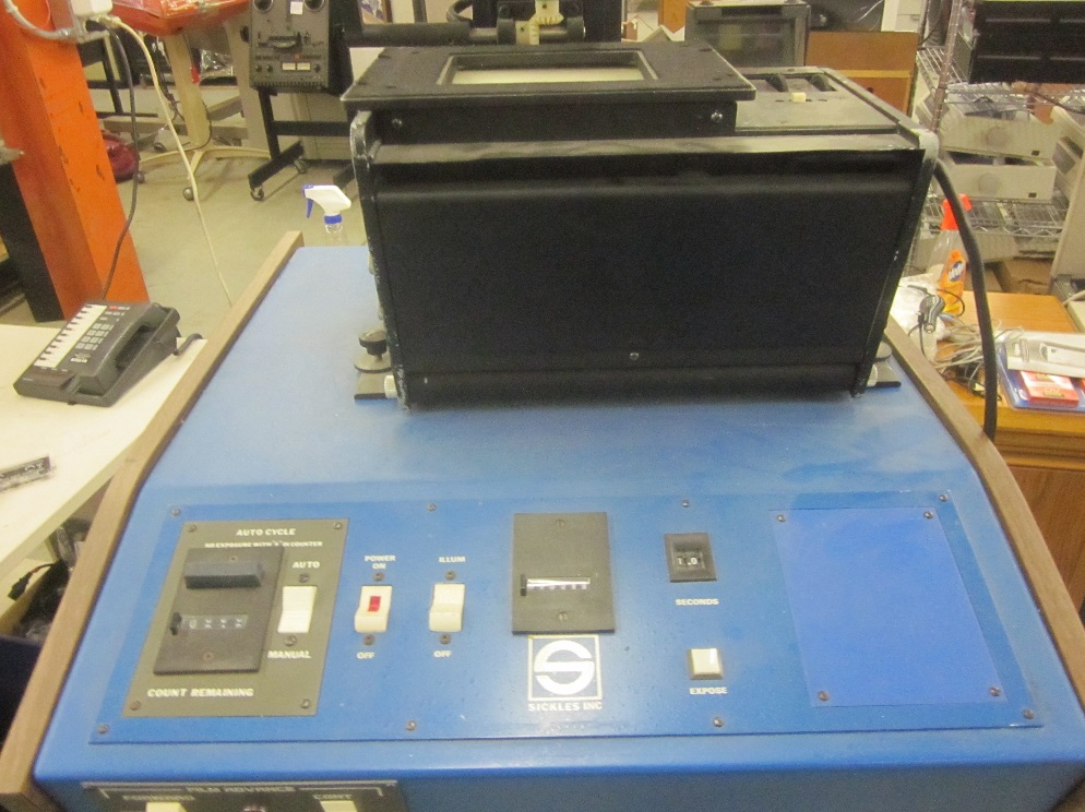

Hi guys,
I'm new to this forum as you can tell this is my first post here. I work for an electronics recycling facility and we do exactly that, recycle old electronics. We are often given old electronics that people have no need for, or we buy estates and try to resell the items that we can find value in. So, the reason I have come to this site is because I found a link on Google in this same thread about this item I have. It is a Super Chromega D Dichroic II. I can't find one similar to it anywhere online. My goal is to sell this (on eBay), but I have no idea what it is or what it does. I realize that in order to list something for sale on this site it is against the policy and requires a subscription, and that is not my goal here. I'm simply looking for some information as to how to list it.. is it valuable? How much do you think it is worth? I have powered it on, and it seems to work, but I don't have a clue as to what I'm doing. Any information you can give me on this item would be greatly appreciated. Here are some photos of this thing:

It appears that you have an enlarger to make traditional prints from film negatives. It is difficult from the photos to tell where your gizmo begins and ends. There is a big blue thing on the bottom and a black thing on top of it. I assume these are not parts of the enlarger but other items used to make the photo prints or to make copy negatives or to calibrate the film to get the proper exposure. You may have three gizmos, not one.

It's an enlarger of sorts; specifically, it's a negative/slide duplicator made for copying 4x5 originals. The original would go on the bottom, and you would adjust the light intensity and color balance via the blue bottom box, and then use the head to zoom/crop in on the original.

The middle unit labeled "Super Chromega D Dichroic II" is of course a colorhead for the Omega D series enlargers, here apparantly being used as a color light source for slide/negative duplicating.
That part should be removed prior to going to the scrap heap. That is one of the best heads for 4x5 enlarging and it still has the 4 thumbscrews to mount it on a D5 chassis. I wonder if the power supply for it is in the lower part of the machine.
On the side, upside down and sideways, is the word CHROMEGA. It appears to be a large scale version of their family of enlargers.

So looking around a bit, this seems to be a Chroma Pro film duplicator made by Magnum Sickles Industries. Apparantly there were various versions, and they could be set up to use different camera bodies, though this one looks like it has a dedicated camera unit on the top for shooting long rolls of 35mm film (you can see the film at the top of the device in photo #4 in the first post), such as might be used in a lab or an institution like an archive or a library. Some seem to use a Chromega enlarger head as a light source, and some have their own built-in light source.
Google "sickles duplicator" for more info.

Most interesting I find that swing-in loupe at the camera stage. And that mirror at the lighting stage.
