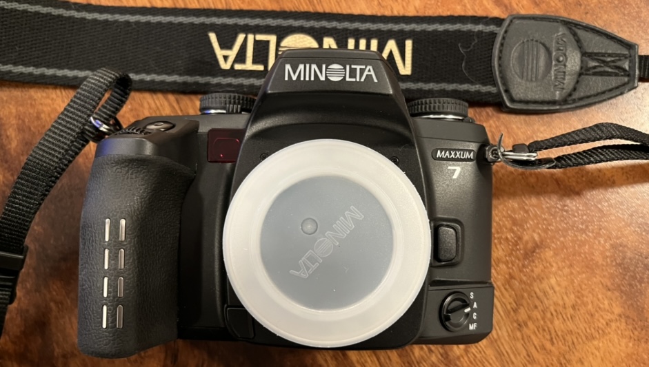

Finally I found my dream camera locally.
Absolute the best ever made.
The 8000 shutter speed makes a big difference.
Everything is in the right place and it feels like I have used the camera forever even though I have never held one before.
Did not come with a lens but considering I got the camera cheap I have a wiggle room.
Which are the shining lenses in the alpha mount?
Downsides?
Tough to use any of my other SLRs when I have the Maxxum7. :smile:

Enjoy! Have spare batteries and lots of film.

Most my cameras need batteries. I have batteries in every pocket, backpack and my glove compartment.
The 7 will work all Minolta, Konica Minolta, and full frame Sony A mount SSM lens. In terms of a bargain, lots of choices. I like the 50 1.4, early 5 pins include 35 to 70 F 3.5 to 4.5 and 70 to 2010 F4, nick named to the beer can lens. A bit up the scale the 24mm to 105 3.5 to 4.5. and 28 to 100 3.5 to 5.6. I have the 100, 135, 200, 300 and 400 for wildlife and sports, all excellent lens. Dont have the 85mm which others say is a outstanding lens as well.
