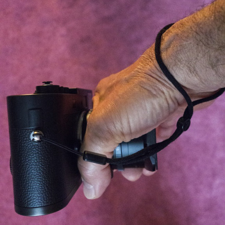

First thing I do when pickup up a cam is put the wrist strap on.
I would have dropped my cams a number of times over the years without the strap.
