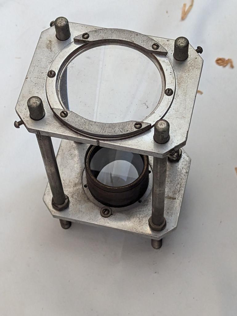

I picked up a very old basic type. Has two single curved lenses that distance can be adjusted.
I cant seem to get it to focus with a camera, not sure how I can use it. Do you need to use a lens or could I couple it up to a lens board and use it direct?
No idea, cost $10 + postage, figured I could find some use for it. Was hoping to be able to use the distortion.
