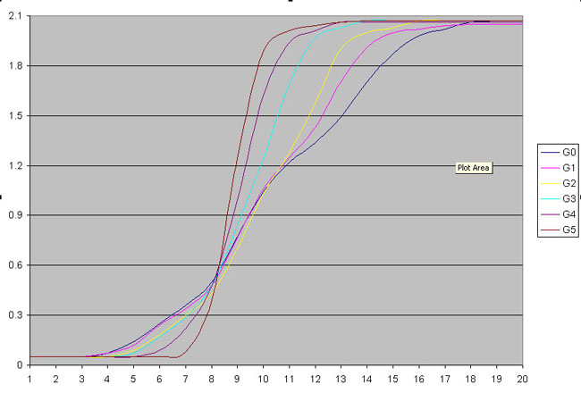

Just for an example, attached is a graph of MGIV-FB developed in Ilford Warmtone developer using Ilford's recommended "equal exposure" filter values for my colour head. X-axis numbers are 0.5 stop steps on my transmission step wedge (actual values not needed in this case as I'm only interested in relative values, not absolute ones) and y-axis numbers are the usual log density values read from the paper using my densitometer.
It shows how MGIV-FB reacts under these conditions. It shows Dmin & Dmax values and shows that the "equal exposure" occurs at about 0.5 above paper base + fog - i.e. in the highlights as you would expect for paper ("expose for the highlights, grade for the shadows").
Also note for example the clear humps in the response in the lower contrast grades. Doing the same plot in Ansco 130 shows a graph where the humps all but disappear. Proving at least, that not all developers are equal...
Have fun, Bob.

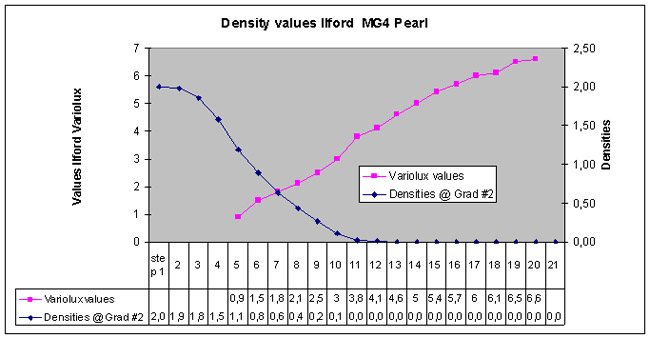

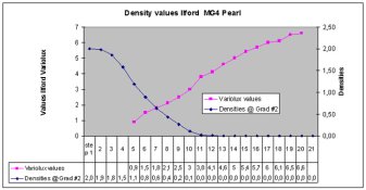

Yesterday I made a some testprints, using F/8 and 8 sec. as my standard settings. The results got me confused though.
In the diagram you can see for instance that to get a density of 0.43 in the testprint (step 8) the dial of the Durst Variolux must be set to 2.1 to get both LED's on. This density represents a medium grey zone on the testprint. But if I make a teststrips of a negative with normal contrast I have to put the meter at approx. 2.25 to get near black in that region (all metering with white light, filters turned out of the lightpath, densities measured on the testprint after developing and drying with a Heiland TRD 2 densito meter).
Step 1-4 and 21 are outside the metering range of the Durst Variolux at the used enlarger settings. Step 1 and 2 are black on the testprint. The Variolux btw seems to be reasonably linear over the total metering range.
Anyone that can give me an idea of what I am doing wrong (or am I interpreting the chart in the wrong way?).
My hunch is that I would have to turn up the light output of the enlarger (i.e. use a wider F-stop) so that the value range of the Variolux shifts to the right, giving a value of 2.1 at the first distinct gray value, density 1.86 or 1.58 in this case.
