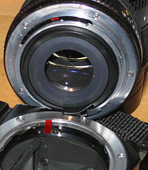

This is not true of the more recent Pentax DSLRs, including the budget K-x. I just came inside from shooting origami boats in the park across the street with mine with the 50/2 SMC-Pentax.
Here is a Pentax K-x with its mount:
http://www.imaging-resource.com/PRODS/KX/ZURFRONT-L.JPG
Where is the coupling between the house and a K-lens aperture ring?
Compare to the picture attached below where i have added some red color to the coupling devices needed to be compatible with a K-mount lens.
Read also this statement at pentaximaging.com, that also supports what i am saying that Pentax K-mount only can be used in manual exposure mode using stop down metering. Only those lenses with an "A" on the aperture ring can be used in automatic modes. An ordinary K-lens has to be used in the same as an ancient M42 screw mount on new bodies.
Dead Link Removed
Pentax is _not_ fully compatible with its old lenses and cannot use them in aperture priority as 30 year old cameras can.
You may not be able to see it, but it's there (more accurately, some of what's necessary is there, for some functions--you seem to think "compatibility" is some all-or-nothing shibboleth, but of course there are different functions to be compatible with).
Dead Link Removed
Sorry, you're just wrong. M42 lenses have to be used in a stop-down fashion (or Av if you stick to shooting wide open).
Non-A K-mount lenses are NOT operated in the fashion classically described as stop-down metering. What is special about the A lenses is that they are made to work with all automatic modes--rather than using the aperture ring, you can/must control the aperture from the camera body. Non-A K lenses DO NOT have to be stopped down manually on the K-x and other newer bodies. They have the requisite couplings to use the auto iris but not to read the aperture from the lens. You set your desired aperture (but the lens is still wide open for focusing, as in any modern system), touch a button next to the shutter to trigger setting of the shutter speed, and take your picture. The only difference between this and normal Av is that extra button touch--there are no extra adjustments, just a touch. The shutter speed is set live based on the wide-open aperture, so if you are shooting wide-open you have full Av.
As noted, you're incorrect/oversimplifying the Av question. That said, no DSLR system is "fully compatible" with all of its maker's classic lenses, but Pentax is a hell of a lot closer than any of the others. Any Pentax lens ever made will mount and meter, which is true of neither Nikon nor Canon. A reader might note you conspicuously dropped your assertion of Nikon being "more compatible" when pointed to charts showing its falsity.

steelneck
Nov 16, 2009
173
Non-A K-mount lenses ..
I am writing about K-mount lenses, you are writing specific about AK-lenses.. That clears it up.
Few old K-mount lenses are AK counting all different brands, including many of the new ones still made today. A 30 year old Pentax, Chinon, Richo, Cosina, Sears, Agfa, Soligor, Zenit, brand new Phenix or Vivitars made today and some more can use plain old K-lenses of a long series of brands, and light meter, and use aperture priority with them as supposed. A new Pentax can not (requiring an extra button push). (edit: this is what new cameras do to photographers, reduce them to button-pushers)
BTW. Those old cameras of many different brands with K-mount can also use the little more recent line of AK-lenses and even some brand new autofocus lenses that has an aperture ring, even in aperture priority.
One of the big beauties with the K-mount was that Pentax did not make it proprietary, other brands could use it as they wished and that lead to a much larger system world wide. It became a selling argument for Pentax in the same way that IBM once released all the specifics around the PC computer, the system became large due to other manufacturers and got a large userbase world wide. This is still today an argument for the Pentax system for someone looking at old cameras like the OP in this thread. That argument has Pentax thrown away, though they are trying to use it anyway. Only reason they get away with it has to do with psychology, the more someone has sacrificed (payed money, time, prestige), the more they are going to defend and excuse the manufacturer just to justify them self, and buyers of new DSLR cameras usually have invested a big enough amount of money to be hurt by negative statement about "their" brand of choise. (edit) This is the main reason to long brand-flamewars on the net.
It is like criticizing the car a hardworking blue collar man from the lower middle class finally bought using all his savings. You risk getting his fist in your face(!), he will take it like an insult to him as a person. But criticize the same car that a millionaire bought and he will just brush it off, or maybe even get curious. It was not a sacrifice that needs to be defended for him. We all work like that. This is how manufacturers can get away with quite bold statements in their ads, buying customers wont complain since that would be an attack on them self and the purchase they just did, especially regarding expensive things. And remember, "expensive" is something very relative to the wallet of the person in question.
No. As mentioned in the line you quoted, I was chiefly talking about NON-A K-mount lenses, as we already agreed that the A versions work in all auto modes. :smile:
It's just silly and factually incorrect to label one extra button push "stop-down metering the same as ancient M42 lenses", which is what you said.
With all due respect, that's a ridiculous set of assertions. Pentax has thrown away far less than *any other major player*, so to single them out can only be called, again, ridiculous.
Well, what "label" we put on it is irrelevant, a new Pentax cannot use the features that old K-mount lenses have. The camera house do not "know" the dialed in aperture and the photographer has to push a special button to meter before talking the shot. I would not even be surprised if this "feature" has to be turned on deep, deep down in some half secret menu requiring reading of a 300 page manual first.. (edit: think about it, what does the new and shiny camera house actually do when the photog pushes that button?)
And the sad thing is that it is done on purpose (if it is not on purpose they are downright incompetent since all it takes is one little pin and a potentiometer) at the same time the they talk about compability without saying just as loud that it is only half compatible. Yes, old lenses can used, but not as they were designed to be able o be used.
I am not defending Nikon either, i have never owned a Nikon, actually not ever even taken one single shot with a Nikon (though i think i would consider a Fm3a if i find one at the right price). And Canon changed their mount completely, and naturally, they do not have to dig them self into this, for good and bad. I will give it to you that i used wrong words saying that Pentax is less compatible than the others. But i will not back down on that they are _not_ compatible because i see this quite black n white, either you are fully compatible or not, or else we could even say that Canon are compatible with K-mount lenses since they can be used on a Canon too.
Well.. to bring us back on Lars Daniels topic, the K-mount is an argument for him to consider since it was used by many different brands, and i have the impression that it was especially big in europe and scandinavia at the time. There are also still some makers of new K-mount cameras and lenses, Seagull, Phenix and Vivitar comes to mind and of course superb (and expensive) new lenses from Zeiss and Voigtländer.
