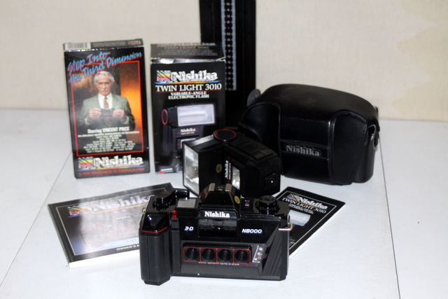

It has 4 lenses, I been wondering what it would take to print your own 3d, but don't have time to play with it, if your interested make me an offer, but if you figure a way I would like to hear about it. Anyway it is complete camera case book video flash and manual. IMG_3578.JPG
