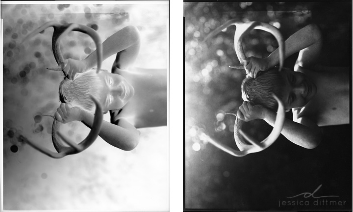

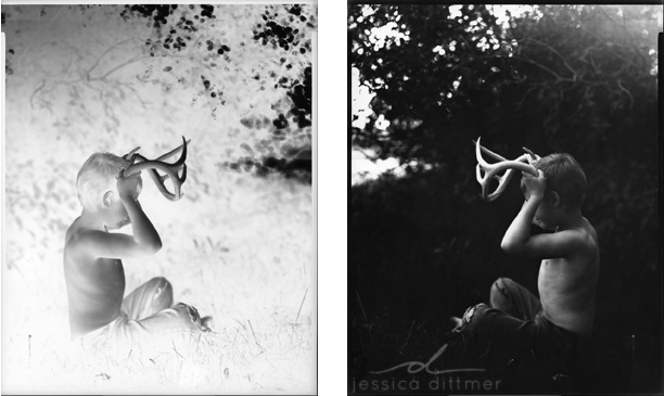

the pos. prints are drying right now. I can scan both the neg and the pos. to show you. I'll post in a bit here after they are dry. basically rated some older ilford rc vc for ISO6 and took a light meter reading accordingly to have setting of f8 and 2sec. then I placed it in a developer tray for 2min. then stop bath, fixer and water. I have a paper neg. Next, after dry...placed it in the contact frame emulsion side to emulsion side with another rc paper and exposed it thru the "neg" paper onto the new one this way with my enlarger open f4 for 1min. 20 sec. (i use a no.5 ilford contrast filter in the elarger too) then into developer tray for 1 min. then stop then fix then water then hang. (this is how mine worked out anyway)...all done in safelight which was nice - even loading the paper to the film holders to start was done in safelight -good for me since I'm learning.

here is some of what I've been up to. straight scans of these with just sizing and name added. I'll check out the direct pos.- haven't seen that yet.

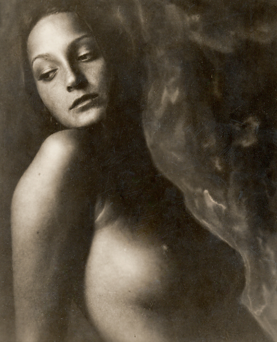

But essentially I don't get such an obvious George Platt-Lynes homage

I'm not familiar with this pic posted above. I'm doing a series of my kids with outdoor things (bird nests, sticks, rocks, antlers etc and thought this was a fun idea- with him holding the antlers up). I'm learning my 8x10 camera and enjoy seeing a bit more immediate results and I like what is coming out of it on the paper. I do plan to work on this more. I would think it is good to have even these new people like me that are excited about processes (even if they are old to other people)...we are at different levels of learning and experimenting- that's not a bad thing. At 35 years old I have a lot more ahead of me to learn I know and new things excite me when I can work with my own hands to do it- instead of digital,etc...

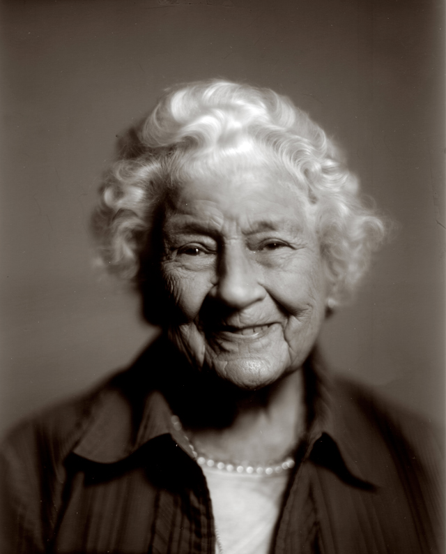

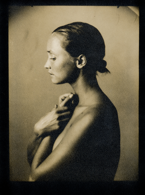

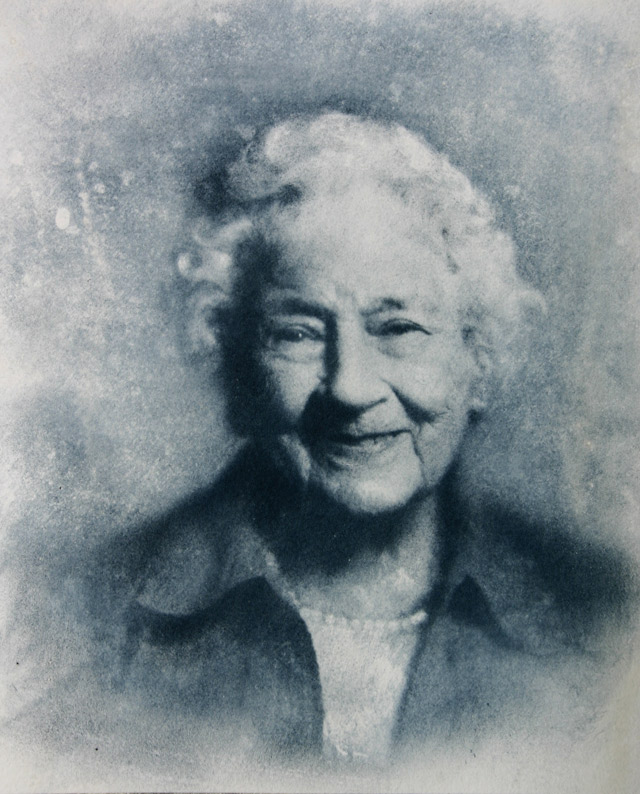

Sounds like you're doing it right. I also use RC papers for nega as they stay flat (easier to make decent contact prints)
But I always use different fiberbased papers for the final print. And I also use liquid emulsion.
attached a few examples:
1: neg scan as is would look on RC paper (toned)
2: same image, but now as bromoil print (after using liquid emulsion)
3: neg manipulated on the back using lib gloss (paper can't see red....)
4: print on the fantastic paper Kentmere Art Classic.
