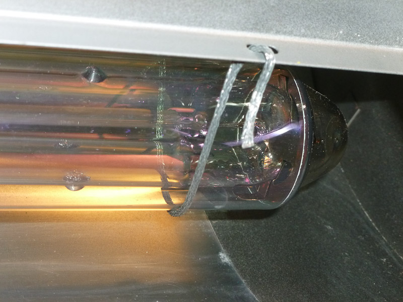

More photos
Last few pics:
1. The small chain or whatever that helps support the bulb was missing so I just used a loop of uncoated picture wire
2. Tools needed for the job
3. Light warming up with gel but no diffusion. At first I thought it might be fine without the diffusion, but that bad boy could give you a suntan! :cool: You definitely need diffusion. You could add as much as you want to the inside filters to bring the light way down, and then use one layer on the vanes to do fine tuning with the pull chain.
Hope that helps.
