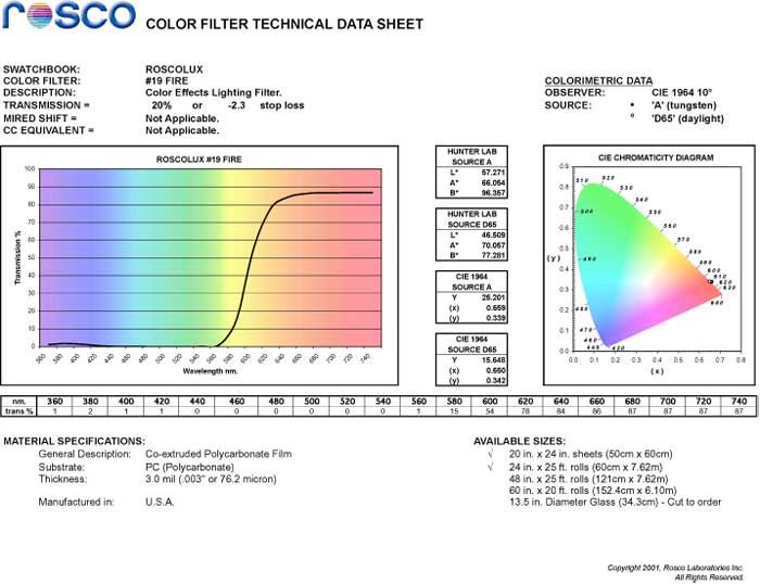

I bought a used $40 Thomas Duplex safelight today. The filters were kind of beat, so I replaced them with Rosco #19 "Fire" which has the right type of wavelength cut off:
The thing is so bright you just don't expect it to be safe, but it is: after flashing some MGFB IV and doing a ten minute coin test with the unit full open, there was not the slightest hint of fog. It's like daylight in the darkroom!

You should check the filters. Mine were all shrunken and cracked, and plenty of unfiltered light would be pouring out of them. Theoretically, the bulb only produces "safe" wavelengths, but at that high intensity I doubt it's very safe for very long. I'll run a test with some MGWT tonight.
The Rosco gels cost about $8 for a 20x24 sheet, which will give you two complete sets of filters for the unit. You could double these up and/or add Rolux (diffusion gel available in various stops). The #19 is 2.3 stops. I considered the Medium Red #27 as well, but it was so dense and dark purple I figured that it wouldn't be a good choice.

What I did was slice the existing tape with a razor, and then soak the two glass pieces (per filter) in water. The old gels literally melt in water. Razor off any stuck stuff, wash with soap and dry. I put Rosco diffusion -- Rolux -- in each pane, so one diffusion gel and one layer of the #19 Fire.
Tonight I flashed some paper to around a Zone VI level, and did another coin test with both MGWT and MGFB. With the unit wide open and the paper at 3 feet, I did start to see fogging at ten minutes on both papers. Even with both panes closed, there is plenty of light in the room, much more than the 15 watt units I was using before. It's nice to be able to see the clock!
Incidentally, I wonder if some of the reports of fogging from these comes from the fact that the filters are some sort of gelatin. Why else would they melt in water? Could the company have used inferior filters? The Rosco gels are polycarbonate, and I've had some of these for 10 years that have never faded or cracked, unlike what I found in the Duplex: both the gel and the diffusion were paper thin, dry and brittle.

The Rosco #19 Fire is a very red gel, and despite that, the light that comes out of the unit is yellow all the way.
The spectrum of a sodium vapor lamp consists of two very narrow energy peaks at about 589 nanometers.
The transmissivity of the Rosco #19 Fire gel is about 50% at that wavelength, which is the only one that matters in this application.
Due to its cutoff characteristics the gel will look red to the human eye.
