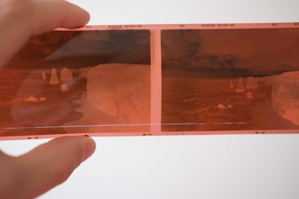

I recently became the proud owner of a fuji 6x9 camera (gw690iii) and I just got my first two rolls of film back from the lab, only to find that one of the two rolls has some very large, deep horizontal scratches across the negatives near the bottom.
This only happened to one of the two rolls I put through the camera. I have checked the camera over - the rollers and pressure plates don't appear to have any rough parts that could scratch film.
I called the lab, they said they noticed the scratches but suggested that they had put plenty of other rolls of film through the processor that day and had no problems with others.
The scratch appears to be on both sides of the negatives.
I need to find out whats causing this, part of me hopes it's something in my camera which i can easily fix (though it doesn't appear to be) but i'm leaning towards it being the labs fault - which is a shame because it would shatter my confidence in getting film developed by a lab and they're the only lab anywhere near me that can develop 120
See attached photos

Hi, I'd go back to the lab and let them see the film. I can't be sure, looking at the images you posted, but it looks to me like the scratch (or gouge) stops and starts several times near at least one of the ends. This, I think, is more typical of something that happens when the film is wet; you might mention this to the lab and see what they say.
That mark looks like a very substantial amount of damage. Usually color films, when heavily pressed like this, get a pressure sensitization effect, and make a darker mark. But yours seems to be lighter, suggesting that it was not done prior to development. But this is a crude appraisal, and might not be right. I'd personally inspect the film with a magnifier to see if emulsion has been gouged out - this is really difficult for a camera to do, really difficult.
In either case, a lot probably just depends on how they react to the problem. Cuz if you don't think you can trust them...

Hi Bill, Thank you for your response and insight. I have a couple of higher resolution images uploaded here -
https://flic.kr/p/VdjhvY
https://flic.kr/p/Wr1BrA
I understand what you're saying about it being difficult for the camera to cause a gouge as severe as this - those were my initial thoughts also. I called the lab when I first saw the negs when I got home (I will be checking them on pickup next time, if there is a next time), they didn't give me much to go by at all. That said, I'll be the first to admit that I don't know enough about the process overall to be able to confidently point fingers, and thats not really my style anyway. I've always been interested in developing film at home, I guess this is the reason to have a serious look into it.
I think that unless I can definitively rule the lab out as a suspect, i'll have a really hard time outsourcing my developing in the future. For what it's worth, the scans they supplied me with were of terrible quality as well.
After all, it's easier to be mad at myself for screwing something up (and learning from it) than do nothing wrong and still have photos ruined.
Thanks again.
Still hoping some others can chime in and help me confirm what caused it

As for the depth of the gouge - it looks to me like it's not far from going all the way through the film...

Ask your lab whether they use dip and dunk equipment or roller transport equipment.

If the scratches are on one roll but not the other, it is unlikely the issue is with the camera.

jakehall I agree with the comments that it is likely the lab machinery that caused the scratches.

I can't really see it well enough from the image posted, but it looks to me to be more like a handling problem when dry than a scratch when wet.
It needs to be looked at carefully in real life.
I'm going to defend the lab - sort of.
If you run a lab, even with the highest standards and best trained, most careful workers, sometimes things go wrong.
Take the film (both rolls) and the camera to them, and see what they tell you.
If they otherwise are a well run operation, with good people and equipment, and handle your problem well, I wouldn't suggest you change.

What I see in the pictures are just deep intermittent scratches on the emulsion.
The emulsion was taken.
This type of scratches (line) usually appear on machines / cameras.
This type of scratch can not be made by hand.
The film goes through a series of machines and cameras:
- in fabrication of film;
- when cutting and packaging the film;
- cameras;
- possible in processing of the film.
Jakehall, you say scratches are on both sides of the film (emulsion and support?).
„The scratch appears to be on both sides of the negatives.”
I do not see scratches on your support.
They would see black on the film.
The scratches that appear on the machines are continuous or intermittent with an equal distance between them.
The fact that a film came out without scratches and another with very serious intermittent scratches I think
the trouble occurred either in the camera or in the film cutting and packaging phase.
In these two cases the film moves intermittently, not continuously.
On a processing machine, a malfunction occurs on all the films.

If you look at the image https://www.flickr.com/photos/132262010@N07/34926274234/ which has the bottom 10 and 11 and the top 53 and 54.
At the top of the frame, outside the frame, between 53 and 54 is KODAK EKTAR 100 photo print.
Under this KODAK a slightly diffuse black stripe is seen.
I think it comes from the mechanical fog of the film (camera).
I come back to the scratch you are claiming at the image https://www.flickr.com/photos/132262010@N07/34926274234/ .
Between 10 and 11, in the middle, it is an arrow from which start emulsion pinches (stings) that run parallel to the main scratch.
I have such stings with my Pentacon Six camera, only on the film marker portion.
