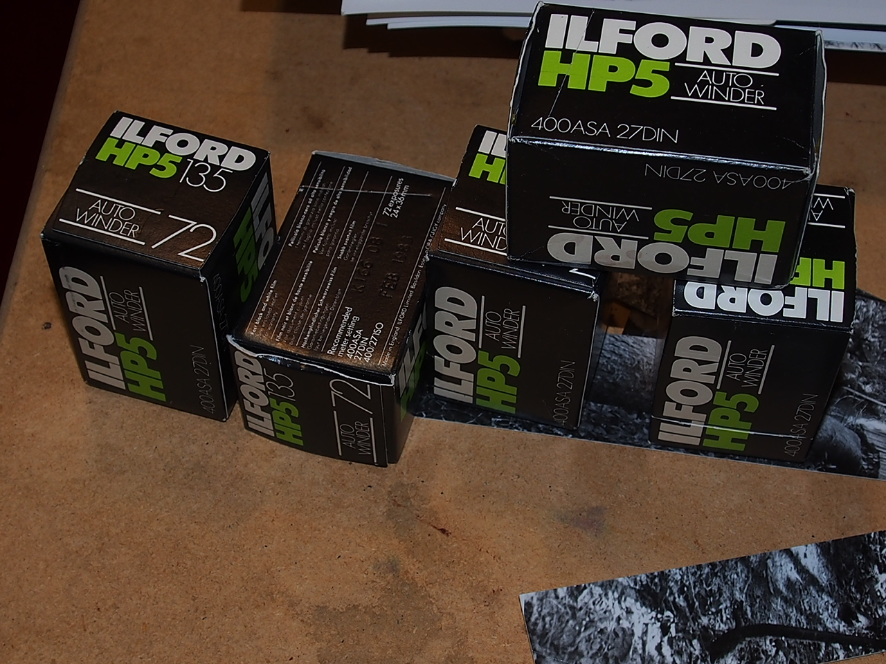

HP5 autowinder February 1983, was it a good year?
Yet another blast from the past to challenge my commitment to the darkroom!
72 exposures is a lot of effort just to test a film.
Time to bring out my dusty motordrive?

Use an slr. Shoot some frames then cut them off in the dark. Expect serious fog and a speed of about 50, if it hasn't been frozen. HP5+ (the current version) ages terribly -- I doubt the old version fares much better.
And @chuckroast is right - you can't fit that length of film on a standard reel.
Did you get the developing reels?
Yes I did.
In my earlier voyage into B&W photography I was gifted with some rolls of HP5 Autowinder and the accessories before it was introduced to the market!
As for then and now, I have never had reason to expose more than 20 exposures or so before the need to develop and print them!
I am retired!! I have the time..
If you want 72 exposures without the drawbacks of expired film, you might try a thin bulk roll of something like Svema Foto 200. You can even do 720nm IR with that at an ISO of around 25.
I still have a few of those in my freezer. I got mine new in 1986. I don’t use them because last I checked (15 years ago) base fog was over 0.6 log d.
Curious how your rolls have fared.
I have both the plastic and metal 72 exp reels, but I usually just loaded on conventional reels and cut ; losing a frame .
I was just gifted the HP5 .
Like the exposed Pan F of my earlier posts ; I will over develop by 20% and add some BTZ.
I like your idea of cutting the film and using regular 'Paterson" reels.
