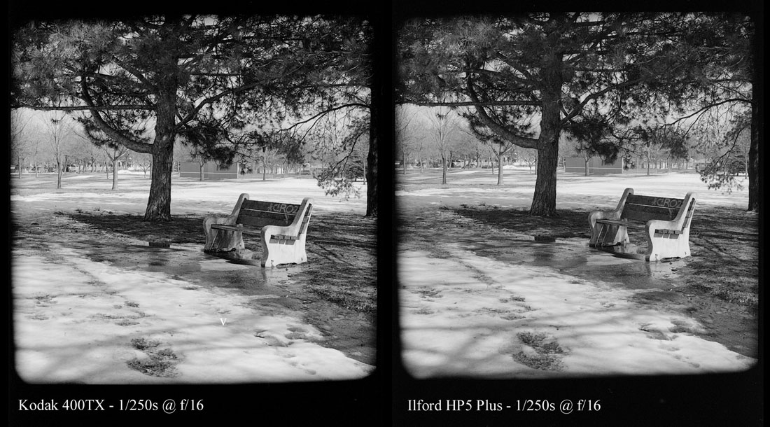

Try HP5 in D76 / ID11. Find the shadow detail you want by bracketing a few sheets. Pick the best one. Shoot a few sheets at that exposure index, and now vary your development time and agitation to get the midtones and highlights you want. You can tweak how the film looks quite a bit.
Attached is a comparison of HP5+ and Tri-X 400 in 120, both developed in Edwal 12. Same scene, same exposure, same development time. Edwal 12 is much like D76 but with a bit more brilliant highlights and finer grain.
View especially the bark of the tree.
- Thomas
- Thomas

Peter, there is a kind of ... softness with HP5 that I don't get with Tri-X. It could be that I need to do more testing, and it may be that I expected HP5 to be a faster HP4. Does anyone else have this experience?
Jan 21, 2003
15,708
Switzerland
I would say that FP4 has more inherent contrast than HP5. To me, Tri-X looks more like a faster FP4 than HP5 does.
I think that HP5 is softer in its appearance, especially in the low values. The adjacent tonal shifts don't seem to be as clearly defined as with other films, for better or worse.

Alan, I believe you, and I guess it is not softness that I am trying to describe (lousy choice of words, especially in a photography forum). I think Thomas (see above) explained it better. It a tonality in the shadows that gives the appearance of softness. Hard to describe. Maybe I will scan some negs and show you what I mean.
