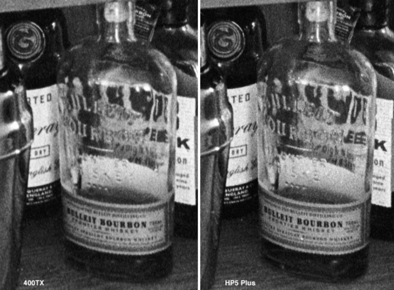

I just found this image on the web. I searched for HP5 TriX and HC110, which is the developer I use. I'm going to get some HP5+ to do my own tests and see if I like the results.

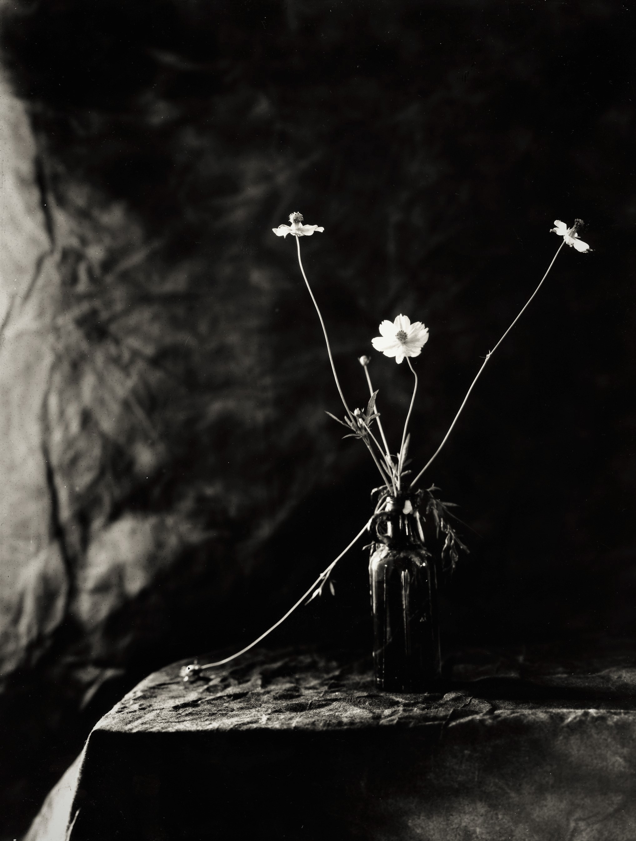

I got the highlights to hold on this print by preflashing.
You might want to bear in mind that (for whatever reasons) HC-110 seems to produce the largest sensitometric/ curve shape differences in the toe/ shadow/ straight line portions of the curve between 400TX and HP5+. It may make no difference to your outcomes, but don't be too surprised if you find there are greater differences in shadow behaviour than in Xtol or D-76.
DMJ your pics are interesting in that they seem to confirm the conclusion that most presenters of videos on Tri-X v Hp5+ come to, namely that Tri-X is more contrasty but HP5+ preserves shadow detail better. Of course in most of not all videos a correct scientifically valid test has probably not been carried out but as far as I can say that the scenes were the same and taken within seconds of each other and the developer was common to both films and at the developer maker's recommended times
So given that the vast majority of users tend to develop according to what the instructions say it would look as if most users' experience would reflect what the videos conclude. My guess is that choice depends on what "look" the user prefers
pentaxuser
