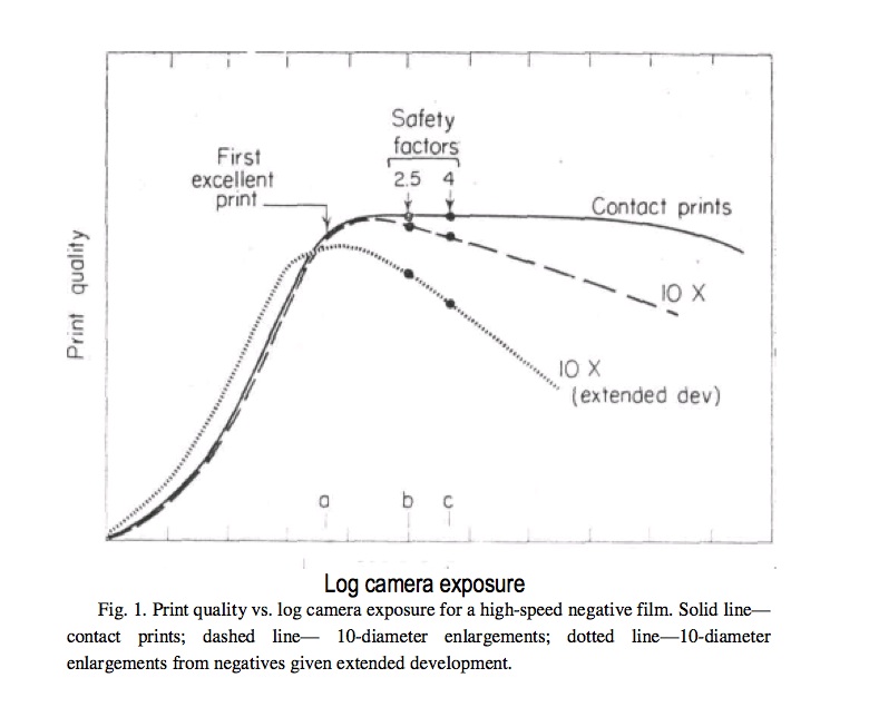

ic-racer
Feb 25, 2007
16,552
USA
Out shooting with my 11x14 camera
actual exposure was wide open
I process normal in these cases. Usually my prints in these cases are not good because the shallow DOF and lack of contrast wide open. I usually print through the extra negative density with 2000W no problem.
