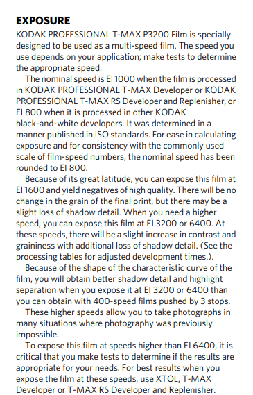

You are right, I don't understand why it is Dx coded at 3200 other than it is a push, the Kodak Professional Black and White Films handbook 1990 says that the "Nominal Speed is 1000 when developed in Tmax developer and 800 with other Kodak developers. So 1600 is a half push 3200 push and a half. But states that you get better shadow details at 3200 than 400 speed films push to 3200 which is a 3 stop push.
It is Dx coded at 3200, and its "box" speed" is 3200, because it is designed to be used that way.
Most film is designed to give optimum results at its ISO speed.
Whereas the 3200 films are designed to perform better at an EI of 3200 than they do at their ISO speed.
The compromise imposed when one sacrifices shadow detail in return for better mid-tone and highlight that "pushing" film involves is designed into the film that way.

Matt - perform "what" better at 3200, in the case of D3200? It certainly doesn't print better. There's only so much can you scrape off the bottom of the barrel. That's why it's important to read the actual spec sheet, which gives its more realistic speed of 1000, rather than just the marketing label, or over-optimistic DX coding. D3200 actually has lovely gradation, at least for moderate contrast scenes, if shot more realistically at a distinctly lower speed. Quite a number of people have found this out.
Matt that sounds like or at least very close to a form of "marketing speak" to me to conflate its aim to be usable at 3200 with labelling that on the box as if it was "box speed"

@pentaxuser, to me Kodak is quite open about it:

Anyway, Ilford asks its customers, especially those who shoot with compact autoexposure and autofocus cameras, to expose this film at 3200. There is a great responsibility in that and it doesn't seem to me that it's just marketing.
Like I already sated, D3200 is engineered to capture "something" when underexposed; but it would be a mistake to assume that that implies an optimal performance from this particular film. I shoot it at 800; and that is exactly what the spec sheet recommends. But I am also a thinking human being who knows what I want, and does not defer those kinds of decisions to any kind of non-sentient rote autoexposure system. Does a DX coder read the actual specs, or look at the actual characteristic curve of this film?
Films like D3200 and TMZ3200 can be used in multiple manners, just like Ilford explains; but that doesn't mean they are, by any normal convention, anywhere near the MARKETED film speed implied on the label. All kinds of products are marketed with overt wishful thinking labels.
However, that does not preclude the norms being leveraged for special low-light applications. So for an impression of just how diversely this particular film gets used, look it up on the Massive Development Chart.

Speaking in terms of the Kodak offering, it is a special purpose film.
I think that the results it gives at an EI of 1000 are crummy, even though the shadow rendition is better at that exposure level.
The mid-tones and highlights look crummy when it is exposed and developed at 1000.
When you give it less exposure - EIs of 1600 or 3200 - and develop it for that exposure the shadows falter, but the mid-tones and highlights get much better.
It is designed that way - and that is why the DX is set that way, and that is why it has 3200 on the box.
