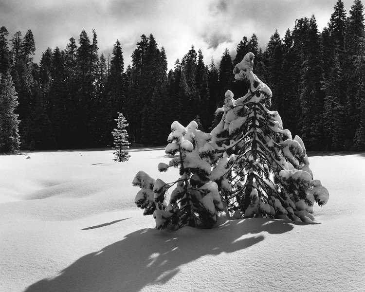

Old Snow:
Proof, 5x7 FP4+ PMK Pyro, (N-1 development)

Precisely. Any film/developer will be fine for snow, if it is exposed, developed and printed with the conditions in mind and some degree of forethought (e.g., previsualization) as to the desired result. The Zone System of exposure and development is a great asset in portraying snow to achieving your visualization in the final print. It is in no way dependent upon any particular film or developer. It is absolute nonsense that one film or developer is better than another, except as regards resolving some parts of the composition as desired to be portrayed by the photographer.
For instance, the images graciously provided as examples earlier in this thread, show almost no texture in the snow itself, which since it occupies a great deal of the compositions, may be assumed to be important. As such, they put me more in the mind of the harsh, dreariness of snow, even in full sun, than its beauty. One can only assume that, if the prints are not significantly different than the scanned images presented in this regard, this was the photographic artist's intent.
ROL, you are right about snow being the main portion of the scene, but that first image of the small store is exactly what I would see on a dull, lifeless winter day here in Michigan where I live. On those sunless days with no cross lighting and everything defused it's almost impossible to get texture in the snow at all. On my monitor I do see lines in the roof of the store, which leads me to believe the exposure was pretty darn close. No sun - dull - dark day = dull, sulky snow scenes. At least where I come from anyway. Also, like you say, we haven't seen the prints. JW

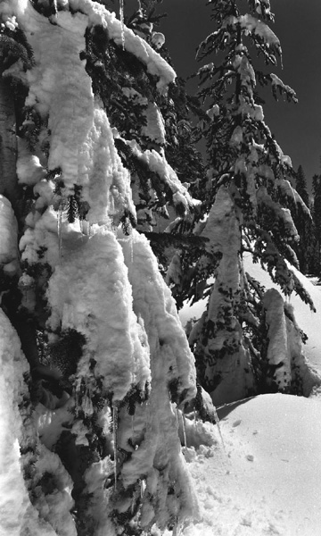

Treecicles, Badger Pass
5x7 Arista Pro, Yellow Filter, PMK pyro (N-1)
Sorry, but WD2D family of developers is not one I have personal experience with. I have used a number of staining pyros, but tend to standardize on PMK, which I like for everything except rotary drum use, and have used for contrasty scenes in all kinds of films and formats.
