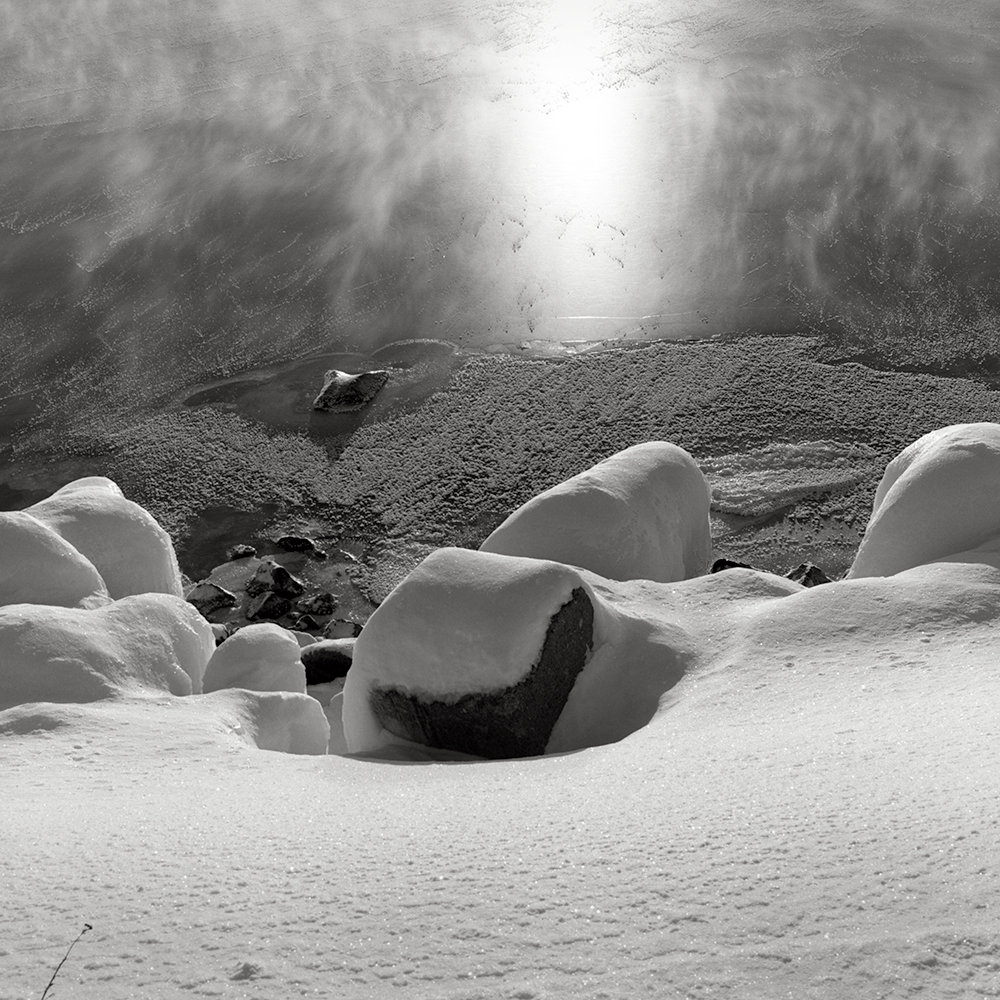

This is TMax 400 in D76 1+1.
Plenty of sparkle and texture. I think it's more down to the lighting than the choice of developer.
Thomas,
That sparkle in the foreground is exactly what I was after. I could see it with my own eyes and in the 500C's viewfinder, but it never showed on the film when I used WD2D+. Maybe I should not have used WD2D+ since it holds back the highlights just a little much. When I have used either Pyrocat-HD or MC the highlights seem a little snappier then they do with WD2D+. The WD2D+ negatives have very good shadow detail and pretty, pure white snow, but not that reflected sparkle. I was a little puzzled??? Well, it's going to be F76+ and Pyrocat-MC for the first two rolls so we'll see what happens tomorrow. JW

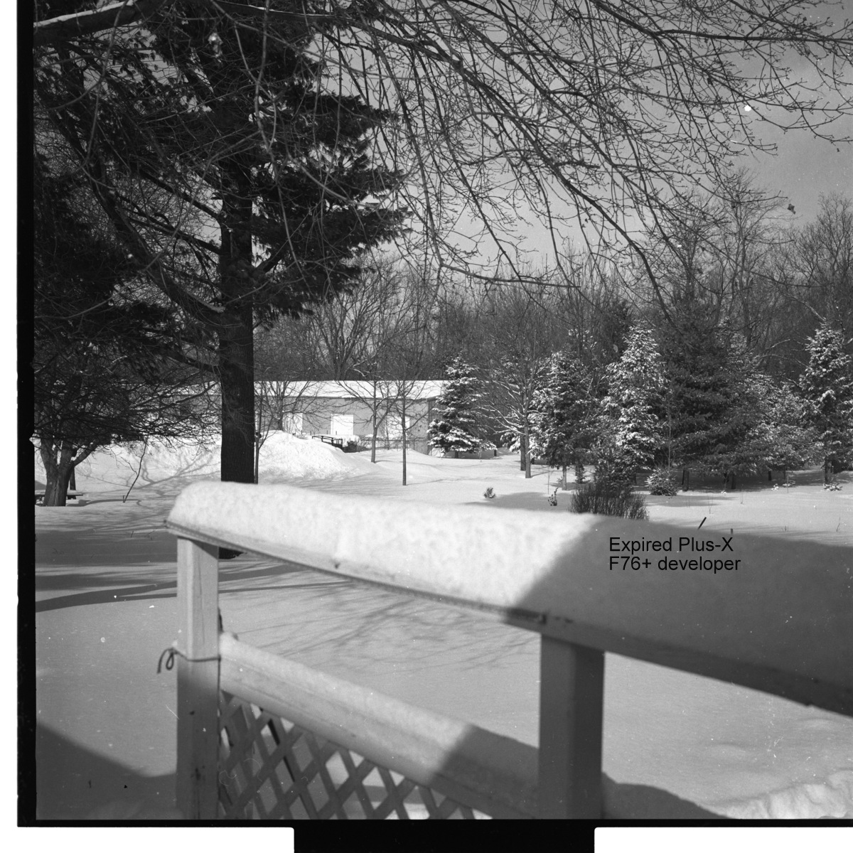

Just before I left home today I took two shots out the backdoor of my house with some long expired Plus-X film that I had forgotten about, which was in a very old C12 Hasselblad back that I didn't even remember having. I processed it tonight to see what it looked like and I'm rather happy with the looks. These are straight scans with nothing done to them. No levels/curves applied at all. Don't mind the dust spots since I did no prep work on these at all. I was really surprised at how clear the film base was for this film since it's close to at least ten years old I think. Remember, these were just a couple of quick test shots. Image1 old plus x and f76+.jpgImage2 old plus x and f76+.jpg I hope HP5+ works this well in Claytons/Arista Premium liquid. JW
Thomas,

Your light and mine here in Michigan are pretty close. I found that WD2D+ didn't seem to separate the high tones/values that much. Shadows were excellent, mid-tones very good, but the highlights in snow seemed to go from a bright grey to bright white with not much in between. That old roll of Plus-X in F76+ looks much, much better in the highlight for separation and texture is there also. Those two shots above were rated at ISO 100 and not metered. I just applied the "Sunny 16" meter and allowed a stop for the yellow filter. Seems to be more snap in the high values and that's what I was after. I'll finish a roll today and might get a chance to soup it tonight.
