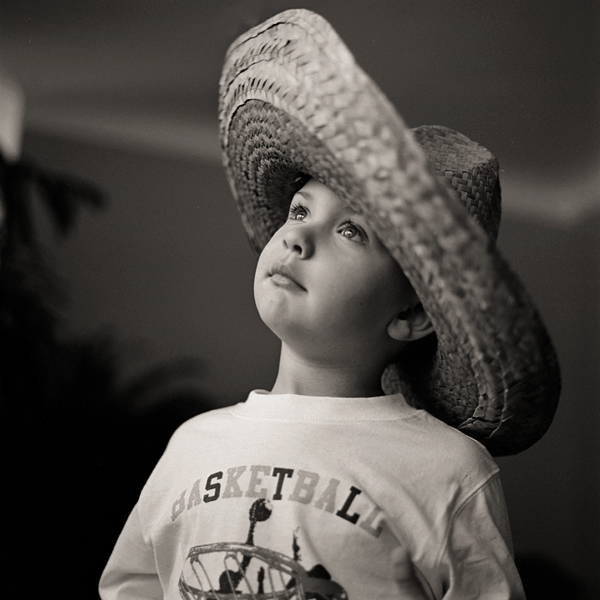

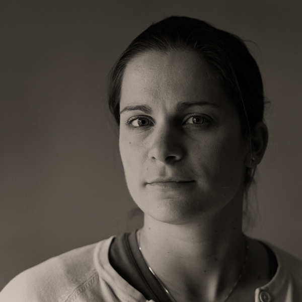

You can also use a different developer to get a different result tonality wise. There are some developers that Edmund Lowe designed, Edwal 10 and Edwal 12, which changed the curve shape at normal speed. They understate the shadows, and give a stunning modulation of highlights right on the edge of breaking up.
Attached examples are Tri-X 400 and HP5+ developed in Edwal 12 (which is a fine grain version of Edwal 10). I'm not going to tell you which is which, because it does the same thing to both films, and in prints I can't really tell a difference. Both exposed in window light, both shot with the same 80mm Zeiss lens, at EI 400, and processed in Edwal 12. To me, TX400 and HP5+ are completely interchangeable.
Edwal 10 gives grain on par with ID-11 or D76, but has a different characteristic in giving deeper shadows (with less detail) and more intense highlights. Edwal 12 gives super fine grain, like replenished Xtol, but is otherwise pretty much the same as Edwal 10. These developers are great for flat lighting. They are not so good for extreme contrast.
- Thomas

I also like those. I like how the edwal really brings out the highlights of the image.
Thomas, those are excellent examples. At what EI did you shoot both of those photos? I'm interested in trying some Edwal 10. Any idea where I can get some? I didn't see any at B&H or freestyle.
Brian,
Both films exposed at EI 400. I could have exposed more, say EI 200, to gain some shadow detail, and then develop for less time. But I didn't feel the pictures warranted it. Shadow detail everywhere, to me, is overrated. I like a good, big, solid black as a foundation in my pictures.
I'm not sure that Edwal 10 is available commercially, but Edwal 12 is available at Photographers' Formulary as 'Developer 12'.
