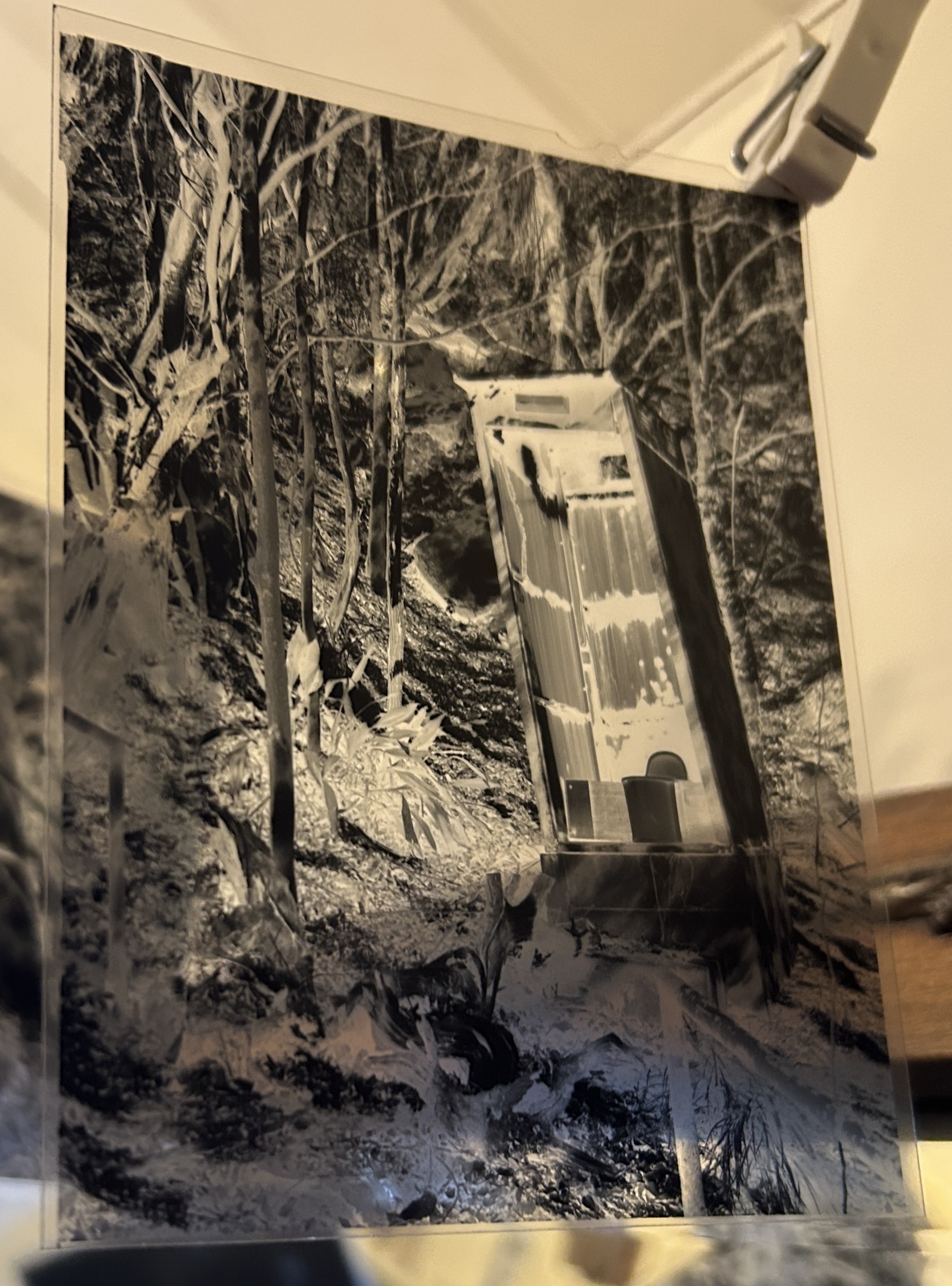

A recently developed 4x5 from my Japan trip…FP4+ developed in Ilford Universal PQ Developer, 1:15, 74F, 10 minutes in drum. There was 6 stops of light in the scene. Printable, no highlights totally blocked up… just on the edge of blocking up. I should be able to coax the most out of the negative ( an old outhouse along an abandoned temple path, Onomichi, Japan.)
I reduced development a little for the next set of negatives.
