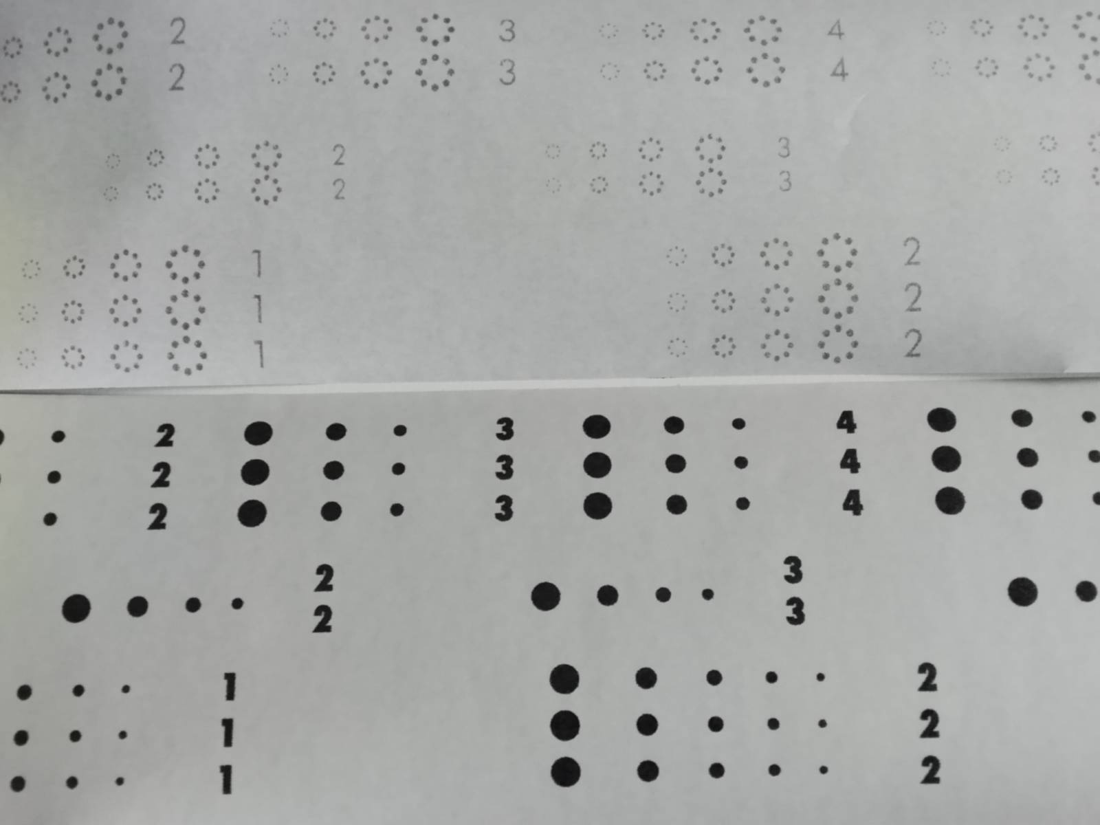

If you have a 120 film camera with red window, you may encounter difficulties reading the numbers both with Ilford and Kentmere films. Harman prints the image numbers on the backing paper very thin to avoid any reaction between the ink and the emulsion.
Foma prints the numbers fat and in deep black. For cameras with the red window I recommend Foma. With the Harman films you may need a flashlight and a magnifying glass.
