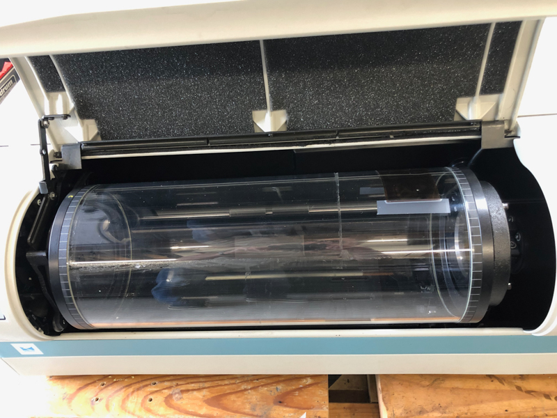

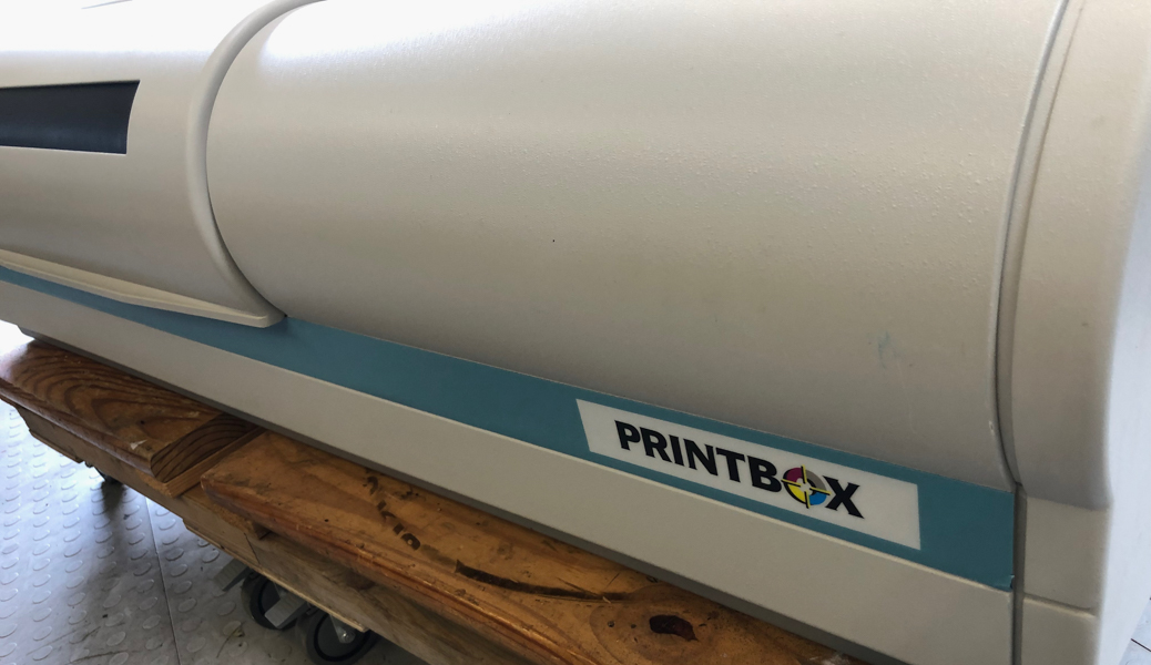

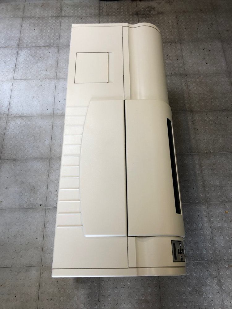

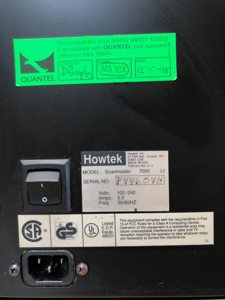

I am in the UK and have recently acquired a 1994 vintage Howtek 7000 Scanmaster Drun Scanner, complete with two spare drums.
It is badged "Quantel Printbox". Quantel was a UK company who developed the poineering Paintbox video graphics system back in the late 1980's. I guess they sold Howtek scanners from the USA as peripherals to their graphics systems under the "Printbox" name.
I would like to get it running again.
I have spoken to a photographer who used to own a Howtek 4500 Drum Scanner for large format work. He spoke enthusiastically about these devices and has encouraged me to have a go at making it work again. He told me that it needs an old PC running Windows XP (or a similar vintage Mac) which can drive the SCSI interface card required to connect to the scanner. He also thought that Silverfast software would operate it. I have a sinking feeling that this might not be quite so straightforward given the plethora of SCIS interface standards of this period!
I have been in touch with Aztek in Southern California, who acquired Howtek many years ago. They kindly sent me links to their YouTube video on the subject and to the Operation Manual. Sadly, Aztek couldn't suggest anyone in the UK or Europe who could provide spares or technical support.
I mostly shoot large and medium format film and use Silverfast 8 with an Epson V850. If I can get a computer to communicate with the scanner I think I will have a racing chance of finding out if it can be made to work again.
I have checked the Howtek unit over without powering it up and it looks to be in good condition despite having been stored for years in a dirty domestic garage.
Can anyone offer any advice or information that would help me to get this amazing piece of equipment going again?

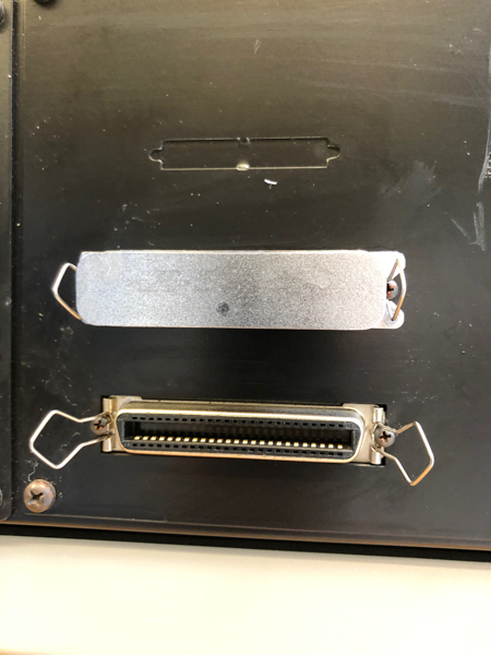

What's the scsi connector look like? They're generally backwards compatible, but it's helpful to know where to start.
I'm not sure what type of SCSI port this is. I need to read up on this. Terminator on the top connector.

OK-- that's a 50 pin centronics "scsi 1" connector.
So first, you need something like this: https://eshop.macsales.com/item/OWC/HDUCX36MB/?gclsrc=ds
And then, for a modern PC (ie, PCI-express, or PCIe), you're looking for a fairly rare card, such as this one: https://www.memory4less.com/lsi-storage-controller-l3-00147-02c
Note-- I don't guarantee that card works with Windows 10, or that your scanner will work with that card and cable combination. I last touched a SCSI based server in about 2008, but after some digging, it appears there is a Window Server 2008 driver which works under Windows 10. The card is actually an "LSI 20320ie" SCSI controller.
