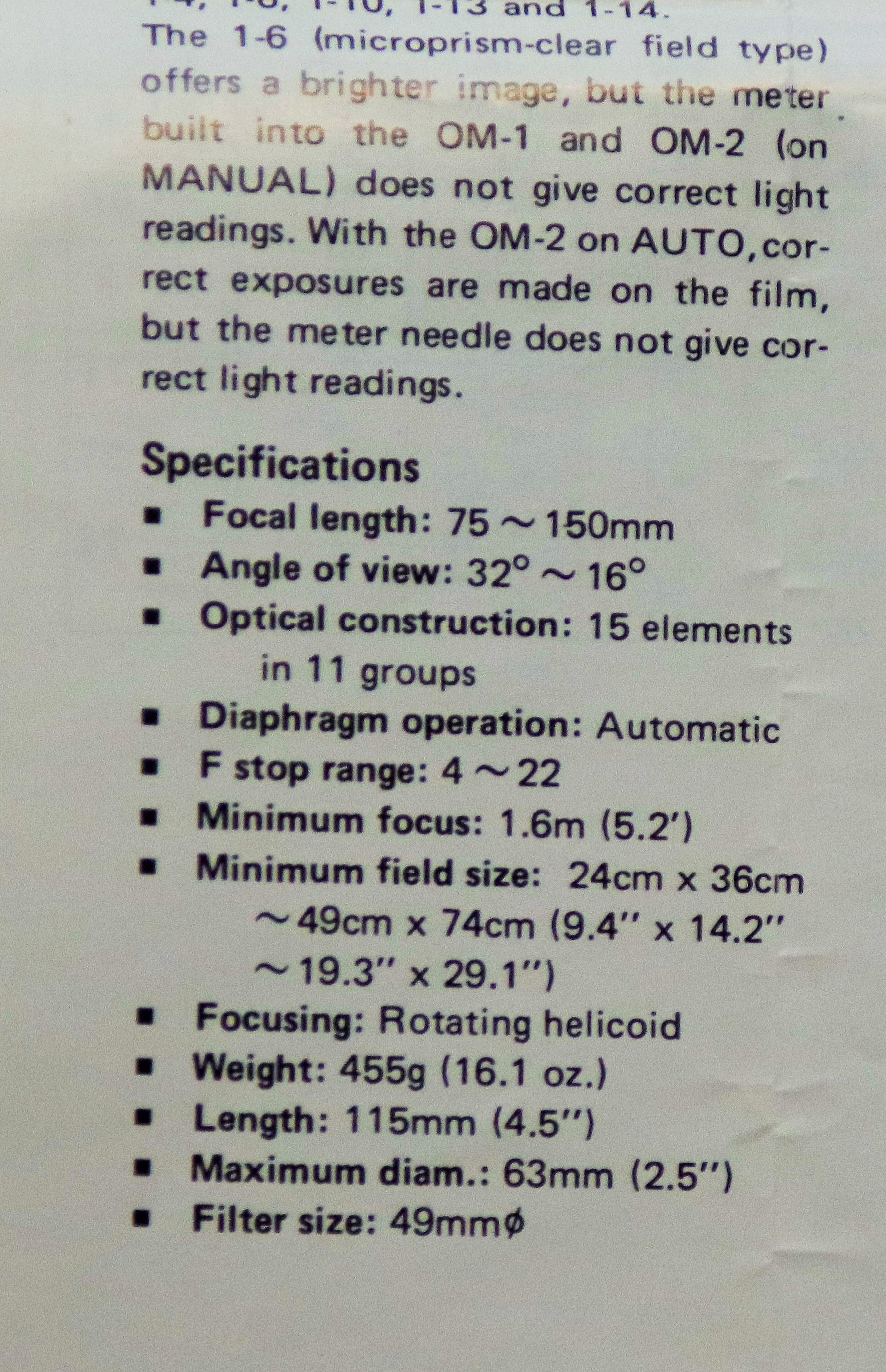

I recall reading in the OM2n literature that this lens won't meter correctly on the OM2n body. What an odd thing, for an OEM lens!
News to me - it works fine on my OM-2n, there is nothing in the manual for the OM-2n that indicates this, and there is no reference to this here: http://omesif.moosemystic.net/om-sif/lensgroup/75-150mmf4.htm
There might be a couple of focusing screens that don't respond well to the f/4 maximum aperture.
Never heard of that. The lens was introduced with the Om-1 & OM-2N, long before any of the other models came out. Never had any problem metering with mine.
That's only with an unusual focusing screen that has a clear field outside the central microprism spot - in other words it does not have ground glass (matte) surface over the full area. Such focusing screens give a bright image but you can't use the field to focus, because your eye will focus on the aerial image whether or not it is at the correct focal plane. You would need to use the microprism spot to focus. The screen scatters light differently than the usual ground glass and is brighter, so it would throw off the in-prism meter (the off-the-film metering of the OM-2 in Auto would not be affected). If you read the fine print at http://www.mir.com.my/rb/photograph...ympusom1n2/shared/accessory/screens/index.htm it says the meter isn't used with any of the clear screens. Anyway, these screens are a piece of system-camera exotica, most of us will never see one.
