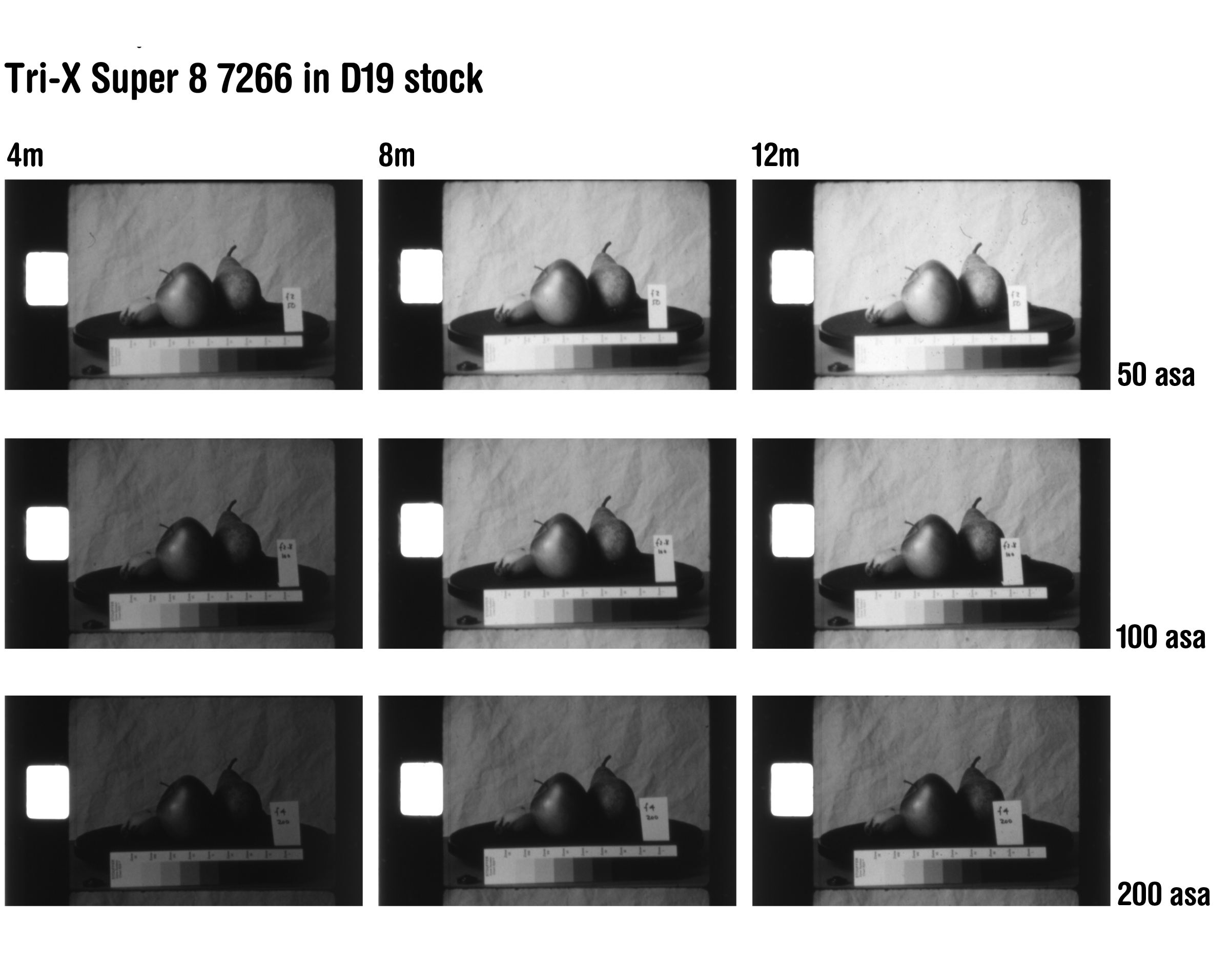

Tri-X Reversal in D19. New EI/dev time tests. Stock at 20C.
You can see that even by 12m I have just reached a usable 100ASA. Increasing from 4m to 8m appears to give a one stop speed increase, The step from 8m to 12m did't gain that much. I estimate that I need 16m to get 200ASA.
The standard (most common) times for this combination seems to be 200ASA dev'd for 6-7mins in stock solution (source: numerous internet samples and anecdotal evidence even on this forum).
Why do I appear to need 2x or 3x the development to get a 'normal' 200ASA result for this film/dev combination?
(And seems interesting in light of the similarly dark positives I was consistently getting from Tri-X 35mm tested in PQ and Liquid Dektol)
Could there be something I am getting consistently wrong in my process (Permanganate bleach/Clearing sol from Foma kit. Same developer at half duration for 2nd dev)?
[You should be able to click through these to get zoomed in version:]
NB. Let me add that I'm pleased to be getting towards decent results but feel that something doesn't quite add up.

looks like between 8 and 12 minutes at ei 100 is good middle grey is in the middle
looks like 10 minutes should be about right. try that.
You also may want to try 1:1 diluition for 10 minutes--it sounds counterintuitive, but some developers need to be dliuted with water to get more power.
don't worry about them other people's times...this is why people give up. everyone elses times always 6 minutes. the 6 minutes is for people adding hypo probably. stay away from that for now. You are on the RIGHT track experimenting with times higher than what other people say. Anything like over 10 minutes, watch for fog developing and overall dmax being lost. just increase the times till your happy or till you start to see ill effects of dmax reduction from developing fog due to too long in the developer.
more diluted may give you a more pleasing contrast too--that may be playing tricks with your eyes as well....
Also--you CAN try to recover some speed by using a ferricyanide (dilute) bleach step after processing if your results are too dark. You can save underexposed film that way--AGAIN at the expense of dmax.
you may want to take pictures of a face or hands or something when you test for a better reference.
actually--on second looking...the 8 minutes looks good per the greyscale

So I went back on my word. I just finished the 16 minute test before I do the Pan-X. Just to call it a wrap.
Tri-X Reversal. D19 1+0 , 16 minutes 1st / 8 minutes 2nd.
Here's the news. Nothing to be gained between 12 and 16 minutes. 100 ASA is still the best result but probably not as good as 12. More contrast and tones crunched.
But then there was only little improvement/difference to the 100ASA exposure between 8 mins and 12 mins so I was kind of expecting it.
200ASA more usable but the bottom 3 zones are more or less combined flat black.
