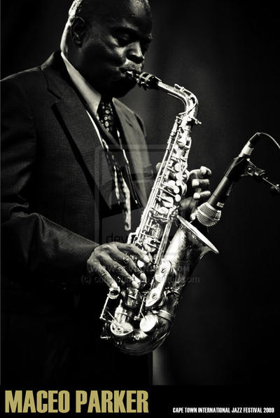

I'm trying to figure out how to meter (spot meter) for a scene that's mostly dark like a stage with spots highlighting band members faces/hands/instruments etc.
Specifically, where would you meter? (shadows or faces?) and where would you place that value (faces on zone 6 or shadows on zone 3 or what?
I took some photos recently of a swing band and though the pictures printed ok, and my negatives weren't horrid, I just winged it and got lucky for the most part.
For next time, I want to have a game plan and know what I'm doing.
This is an example of what I have in mind as the finished product.

My guess is the photographer who shot the photo you used as an example placed the sax player's face on Zone III or Zone IV.

Is it possible the example image of Maceo is a studio shot not live? Live is tricky. If someone is in a spot light the contrast range between dark and light is probably way more than the print can show. The usual thing is to capture the highlights (expose for the highlight of the face or the instrument depending on the subject and placed on zone 8) and sacrifice the shadows, they will be full black without detail. This method has the advantage that it gives shorter shutter speeds which is helpful when shooting handheld. When the subject is not in a spotlight the contrast range is probably less extreme but I would still meter for the highlights since the shadows are probably empty. I work with a spotmeter calibrated for zones 1-10 and chose to expose for print highlights with detail that should fall in the zone 8.
