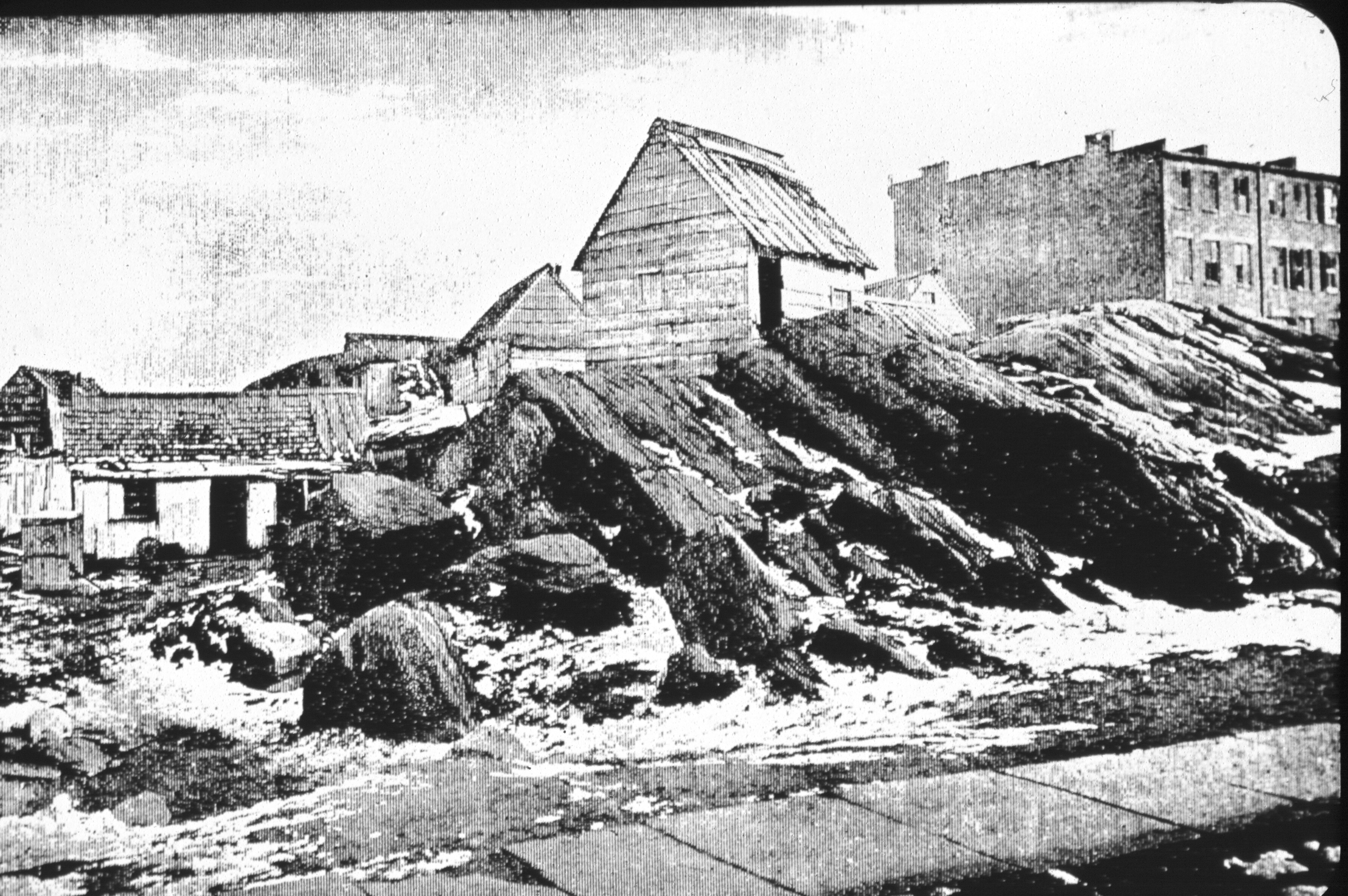

An old photo almanac led me to the March 4, 1880 halftone "Shantytown, New York" which led me to Stephen Horgan's half-tone...
It appears from the narrative, that the first halftone screen was made out of cardboard by Stephen Horgan...
And the next ones were two line screens of glass cemented together... square apertures pierced... one-third the area of the opaque plane surface.
https://archive.org/stream/horganshalftonep00horg#page/n109/mode/2up
I was intrigued by the story of the first printed halftone so I started looking for it...
I found an academic slide of this on eBay and ordered it.
The resolution of the slide is high enough to reveal all the detail that was printed.
Its a line screen, so at this stage Stephen Horgan hadn't introduced the dot screen...
Often times a halftone pattern will interfere with a subject.
But not in this case. The subject matter fits a line screen very nicely.
Boards on the buildings cross the screen and make the buildings "look" more detailed.
The tire against the wall of a shack "looks" like it has spokes.
Here is what it looks like, a little more detail than elsewhere on the internet...

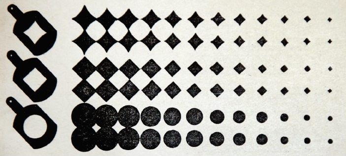

To answer your question directly, the copy was made with a film negative using a process camera, usually a gallery type of camera using either cut sheet film or roll film. The largest camera we had was a Klimsch Gallery Kamera from Germany which was capable of doing a 1m square negative. The film was held on the back of the film plane with a vacuum back. The screen ruled glass plate was some distance away in front of the film, I believe from memory around 30-40mm, in front of that was the screen dot aperture and in front of that was the lens with its own f/stop aperture like what you are familiar with on your camera.
One of the first things to realise is the screen ruling, which literally refers to a rule or line gauge, of so many lines, or rules per inch. There are of course metric rules for line gauges, but we’ll stick to inches. Rules per inch in normal wet ink printing parlance, is referred to as Lines Per Inch, (LPI).
For magazine work on quality paper stock, the minimum would usually be 150 LPI, finer stuff with better inks or processes, would often be 300 LPI. LPI can be higher, but by and large 300 LPI is usually adequate for most fine reproduction work using an analogue film process.
Essentially on the horizontal lines you would have around 150 LPI from the top to the bottom, with the vertical lines running from left to right at 150 LPI. On the best screens we had, all of these lines were on single sheets of glass and were manufactured in Germany. All other screen rulings we had, were on two glass sheets sandwiched together. Cheaper acrylic/polymer seemed to be a really good way to get the same quality as glass, but as far as our production house was concerned, those screens really didn’t cut the mustard.
The distance the screen rulings on the glass plates were away from the sheet of film also has an effect to the overall outcome; another variable.
The shape of the apertures can and did make a huge difference to the outcome and dependent upon the material being reproduced and the printing process down the track, the camera operator would select the most appropriate aperture shape. Generally though, most trade houses I was familiar with in the seventies, eighties and into the early nineties, would pretty much use the same type of aperture for everything.
