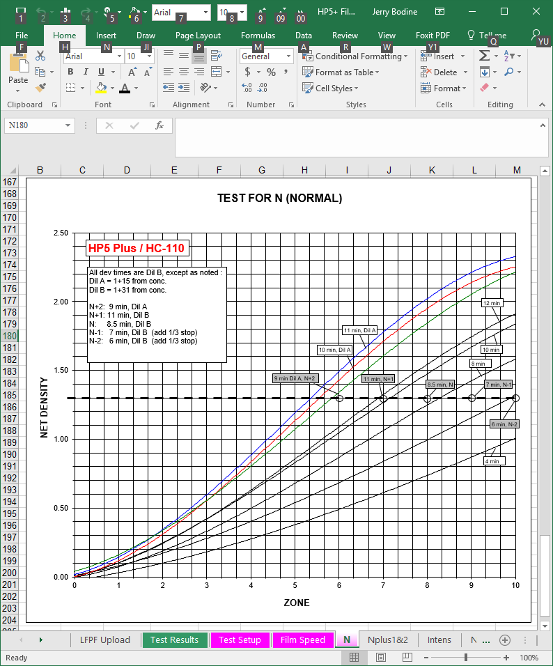

If it's any help, here's a screenshot of my resulting 31-step wedge tray-dev shuffle (6-sheets once through the stack every 30s) for HP5+ in HC-110, 68F/20C. I also have done this with FP4+ in HC-110 if you're interested. Net Density Zero is film-base plus fog. Also note the loss/gain in film speed.
