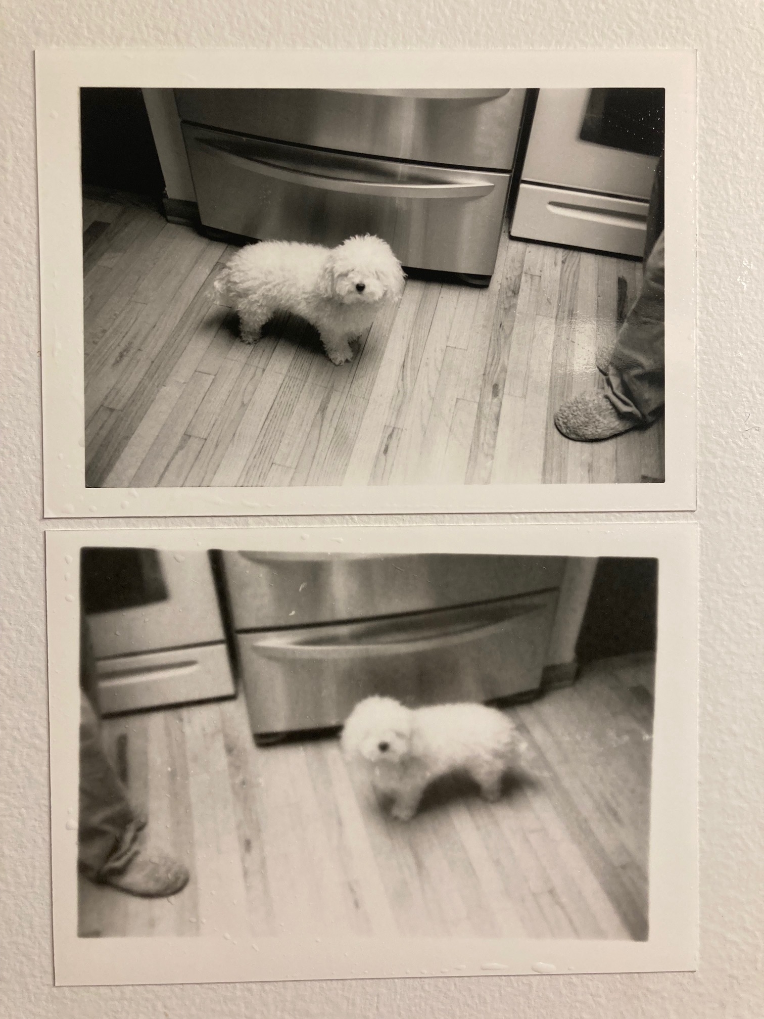

Don't judge me too much on these, I just popped them off real quick to help prove the point. The top image is paper emulsion side up, negative emulsion side down. The second image is the paper emulsion side down, the negative was left in the same position as the first. You'll notice the biggest differences between the two are sharpness and the bottom print is backwards. The only change i made from top to bottom was I guessed at opening up 2 stops.
Hopefully I don't get in trouble for posting this image.
One way to make a fuzzy dog fuzzier.
the bottom dog photo is how my flower prints turn out, and even the good arista test print of my chickadee is sort of blurry on the edges like the dog, but chickadee has better detail showing in the chest feathers
You don’t have the dog’s permission?
I was under the impression we needed to be subscribed to post images.
I think that relates to gallery images, but I could be wrong. 🙃
I'll say this to snusmumriken:
1) great minds think alike; and
2) you have it exactly right! 😁
And to rcphoto:
Thank you for doing the test. And feel free to post images in threads that are appropriate to the threads.
