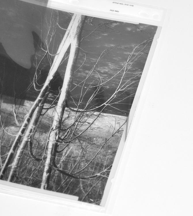

Related but somewhat tangent to the subject; Shanghai 8x10 film will expose fine from either side. Ask me how I know....they punched marks on both corners of the film.
