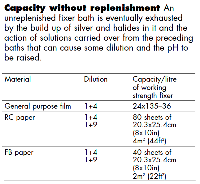

I just thought of a problem with my idea: For paper the fixer is often more dilute than for film. I'm using Ilford rapid fixer. For film it's 1+4. For paper you can use that, or 1+9.
EDIT: Doesn't mean that my idea can't work. But I'll need to think about it a little bit. I could adapt @darkroommike 's advice: Test the clearing time with fresh paper fixer and when then clearing time doubles, it's time to replace the fixer.
Strangely, for paper the capacity of the working solution is the same for 1+4 and for 1+9. I suspect that the reason must be that the limiting factor is not the fixing agent but the water solubility of silver halides or some other byproduct.

EDIT: The Ilford rapid fixer instructions say that for RC paper you can safely use fixer with 4-6 g/L of silver. This test strip you found is perfect for measuring that.
The reason that the capacity of prints per litre of working strength is the same for both 1+4 and 1 +9 is that the controlling factor is how much silver + halide load is in that partially used litre of working strength fixer.
Once there is too much silver in there, it can't do a good job fixing.
